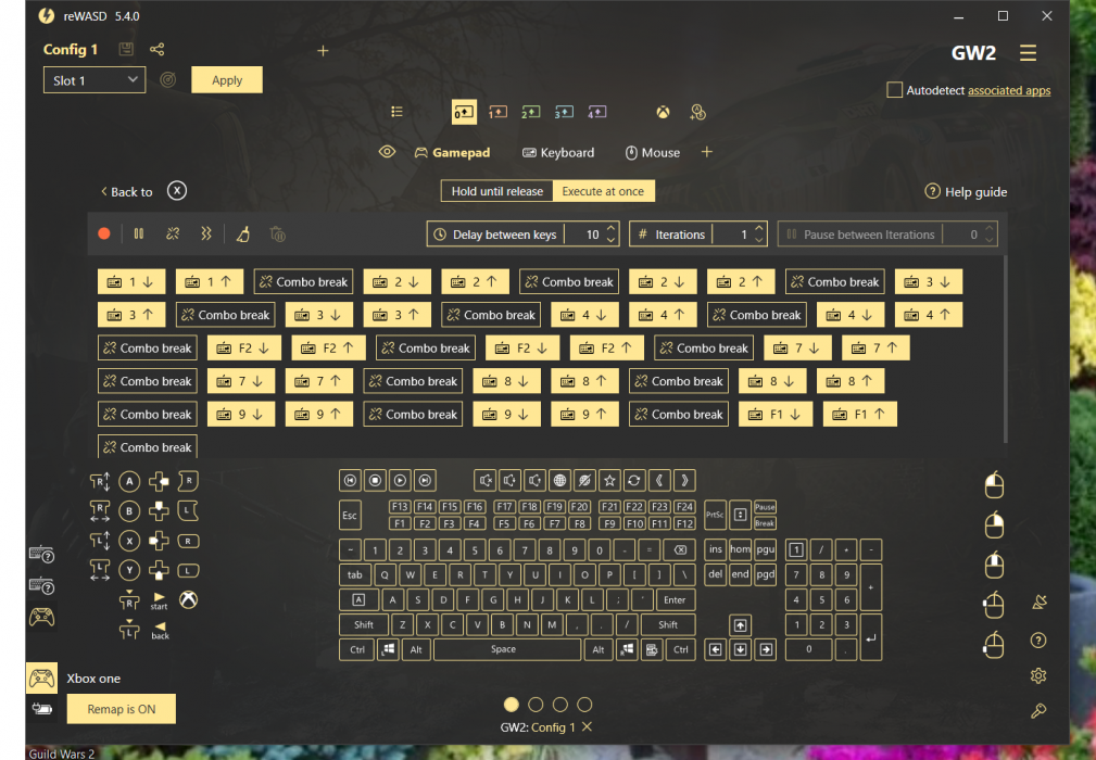

I'm playing GW2 and I made a macro with the ReWASD combo feature. Now the problem is that when the fight is over, where ever I stop pushing the macro will stay there for ever. So when I decide to start a new fight the macro will trigger in whatever last-fight-spell I used which is problematic in this game. It is possible to set a reset time to the macro, let say for example three seconds everytime I stop pushing the button to go back to the first macro keystroke? Or, will be possible that I can add number 1 key to every button push plus the already setup macro keys? (In number 1 I have the basic start attack)
How to set reset time to a macro?
