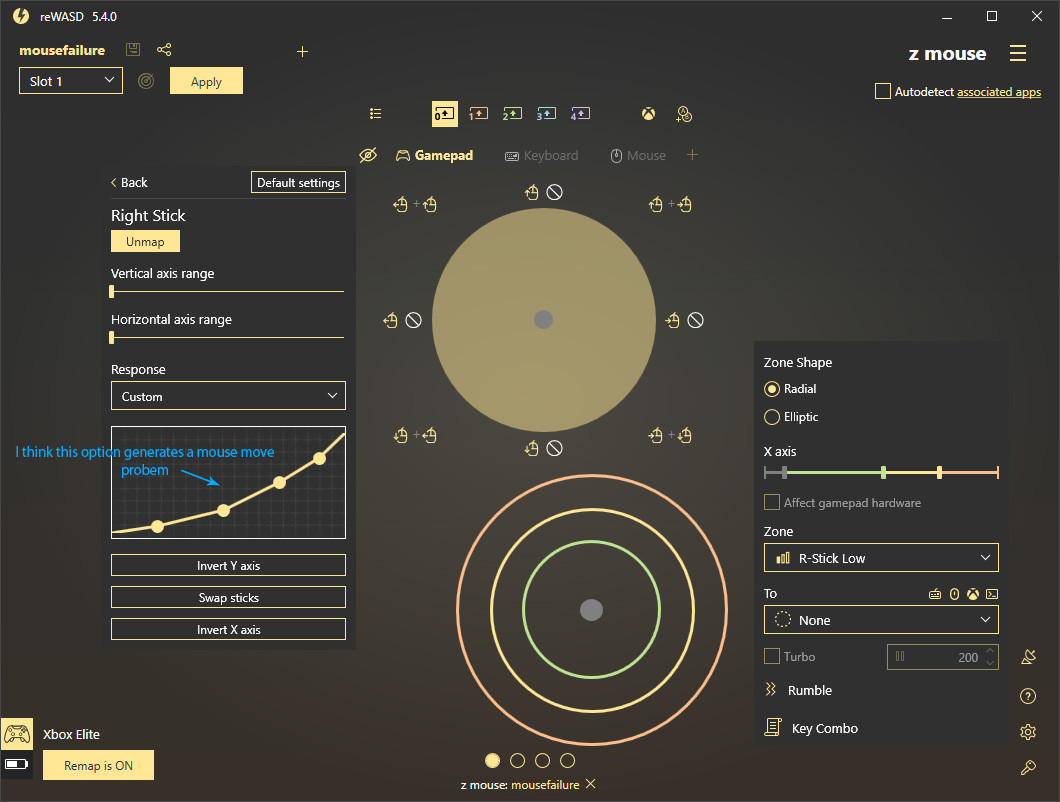

    I map right stick to mouse to play FPS games. But sometimes one direction will just not work, but other 3 directions is ok, and if you pull the stick to other direction, then the direction didn't work will work again. It is fatal in FPS games, and I'm sure my controller has no issue. Another thing is that the stick maps the mouse. When the moving speed is very slow, the view movement is not smooth. Can you optimize this?

          I would like to say, that the similar problem has already appeared before in version revasd 4.1.1 and has been fixed in version 411-0998. Now the mouse problem has returned from rewasd version 5.3.
          I think the problem arises when we change the shape of the motion curve. If it is default, then there is probably no mouse problem.

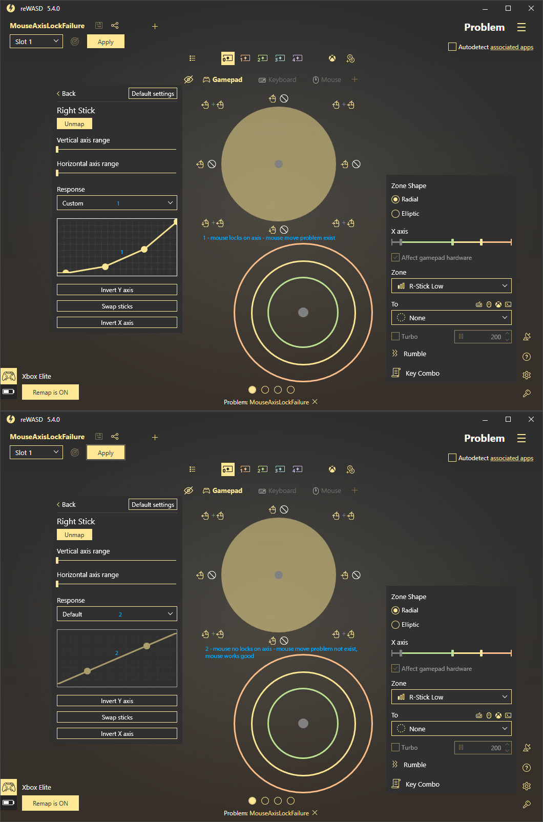

                      On this ventus vido we can to see Y-axis lock failure, i noticed the same problem with my config.
                      Mouse movement sometimes locks when we pass the x or y axis.
                      In this situation, despite stick inclination, mouse movement can not pass through the axis, but it can move along the axis. To unlock the movement of the mouse, you have to stop stick inclination.
                      Mouse movement locks only when we choose Custom Response and we will change the curve.
                      If we change: vertical and horizontal axis range to zero. and will reduce dead zone, the effect can be appear more often.
                      Mouse movement locks usually appears during slow opposing movements with a small deflection of the stick.
                      To notice this issues, you need a little patience, because, for the most part of the time, the movement of mouse is good.
                      Times of the mouse movement locks on the x and y axis on the following example video:
                      01:08 - 01:17 X-axis lock failure
                      02:40 - 02:49 Y-axis lock failure
                      03:24 - 03:36 X-axis lock failure
                      04:02 - 04:16 X-axis lock failure
                      05:26 - 05:40 Y-axis lock failure
                      05:58 - 06:09 Y-axis lock failure
                      06:38 - 06:49 X-axis lock failure
                      06:59 - 07:10 Y-axis lock failure
                      [link expired[
                      Click image for larger version  Name:	mouseaxisfailure.jpg Views:	1922 Size:	298.4 KB ID:	219625
                      MouseAxisLockFailure.rewasd
                        Thank you for your videos and detailed explanations! We will investigate the problem and back with updates.
                          Hey here guys!
                          Yep, the issue is confirmed. It is much harder to reproduce it than back in 4.1.1 but seems I see the steps.
                          We will try to fix it in the next version that is coming in the middle of summer. Stay tuned!
