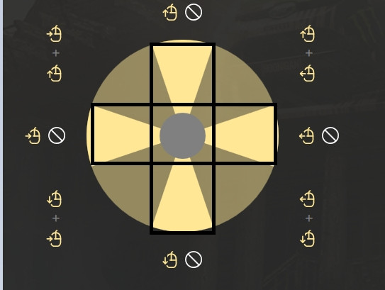

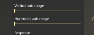

    And I have another suggestion about the axis range. When I set the horizontal direction to 30 degrees, it means that I can't think of turning the horizontal direction to the upper right less than 15 degrees, which will cause a sudden change. Is it possible to compress the 90-degree interval to the remaining 60 degrees?
    • #32
      I'm sorry, it seems I can't understand you.
      Ranges could be changed from 0 to 45 degrees only. Could you please draw what you want to get there?
      Also, when you map the virtual mouse to the physical stick, it is highly recommended to set both ranges to zero, otherwise, you won't get flawless movement.

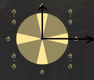

        Take this picture as an example to establish a polar coordinate system. You can see that I set 0-15 degrees and 75-90 degrees range, it is completely horizontal and vertical.
        When input a value in this range, it is a 0 or 90 input.This means that I cannot input a real signal in this range, except for 0 and 90, all other signals are between 15-75. From the angle only, when I keep the x input unchanged and push the stick up, y gradually increases, and this angle will suddenly change from 0 to 15. I cannot input a signal like 8 or 83 or something else. Is it possible to map the range of 15-75 to the range of 0-90? (It does not specifically refer to 15 and 75, but refers to mapping the values outside the range to 0-90, so that these inputs covered by rang two will not be lost.)
        I hope I made it clear this time If there are any questions, I will try to explain again. Thank you for your patience.

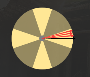

                      I am sorry for my late reply, let me make one more guess
                      Do you want the axes range to look like this?

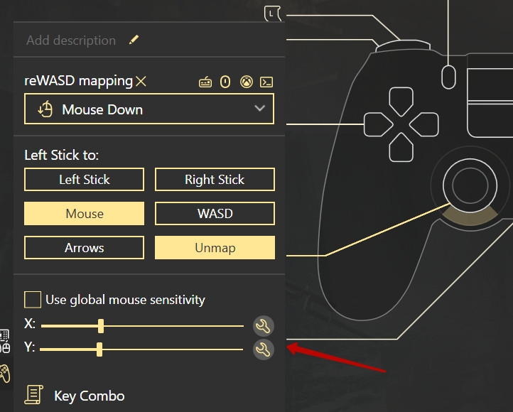

                      Also, can the speed of the mouse be doubled?
                      Yes, this is possible. You should tune Sensitivity after you map your mouse to the stick here:

                        No, you completely misunderstood what I mean.Follow my thoughts and calculate first.
                        First, when we input, we will get a pair of x and y native input values.
                        Then we calculate and convert the direction of the pair of (x,y)values to an angle(degree alpha).
                        If I set axis range as 30 degrees.So when I input an angle of 10 degrees, the output result is 0 degrees. The current function is that when I input 16 degrees, the output result is still 16 degrees.
                        But I want it to be converted. result = f (alpha) = (alpha - axis range/2)/(90 - axis range)*90.
                        What I mean is even if I set an axis range of 30. I can still output the actual angle covered by the axis range, which is to map each quadrant cut out of the axis range to a full 90 degrees, instead of simply covering it.
                        For example, in the first picture, when I input any direction in the axis range (indicated in red), the result is zero degrees (indicated in black)
                        Looking at the second picture, when I input any direction outside the axis range (indicated in red), the actual effect in the game is the direction of the black arrow (indicated in black), and the final output range is possible in the axis range Inside, each group of red and black arrows is indicated by a green arrow.
                        My focus is on the angle rather than the x and y values.
