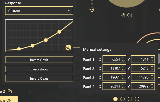

                • #23
                  Just tried the new version with the manual curve inputs. I was able to get a decent solution though it required an open notepad window, a calculator, and 20-30 minutes.
                  These are the notes:
                  Code:
                  max = 32768
                  p1.y --> 0.2^2 --> 0.04 * max = 1311
                  p2.y --> 0.4^2 --> 0.16 * max = 5243
                  p3.y --> 0.6^2 --> 0.36 * max = 11796
                  p4.y --> 0.8^2 --> 0.64 * max = 20972
                  interval = 6553.6
                  p1.x --> 0.2 * max = 6554
                  p2.x --> 0.4 * max = 13107
                  p3.x --> 0.6 * max = 19661
                  p4.x --> 0.8 * max = 26214
                  As you can see, pretty complicated but I did manage to get a nice curve out of it.

                  I think I could get a slightly more accurate curve by spacing the X values exponentially instead of linearly but that will require some more tinkering. I may just write a script to do this calculation quickly.
                  One major issue I had inputting the values is that there are constraints placed on the values that interfere with typing the numbers in. The solution I came up with to get around this was to set ALL x and y values to 0 and then input them backwards, from point 4 to point 1.
                  • #24
                    Thank you for your feedback.
                    Glad that you're like it. As for manual inputting, N + 1 point on X or Y must be greater than N point, i.e all points should go increasingly. But the way you made is also elegant
                    Have a great gaming experience.

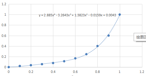

                            • #29
                              We are planning to add other types of curves that won't be related to points, so I hope it may do the trick.
                              Could you please send me the function for the curve you want to get?
                              However, I can't promise you any fast release dates, it won't be done in the upcoming version.
                              This is the fitting curve I got after testing Battlefield 1 and Battlefield 5. But because it is based on the scattered points, the result is a polynomial, which is a bit strange, and there should be a better solution than the polynomial.
                              • #30
