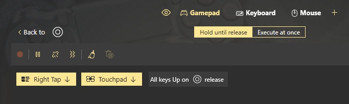

              Anyway, could you please try to set Start and Release with the combos of tap and click:
              Click image for larger version  Name:	a1c2682d34.jpg Views:	0 Size:	24.9 KB ID:	220004
              Use Hold until release mode.
              It does not detect taps, the click is required.

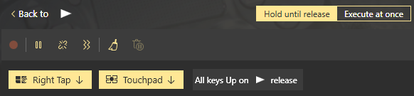

                I can't get it to work that way even though I had it configured like that in the first place. I had also tried with execute at once but with bigger delay, a combo that does work on PS4 games. Did you get it to work by reconnecting the controller several times in a row or something like that? It doesn't work on other buttons either. Emulating other buttons (e.g. Cross button on the Y/Triangle button) works though.
