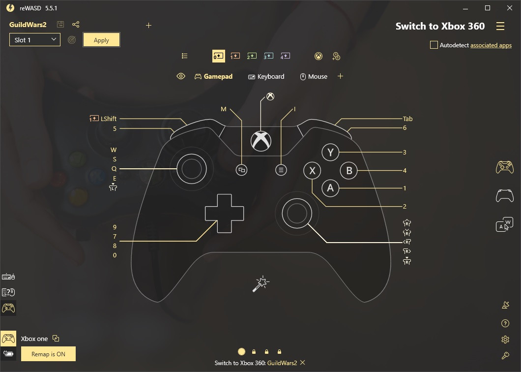

    2. Check the Advanced stick setting. Perhaps there are additional mapping to zone or directions (screenshots). A stick remapped to WASD usually behaves like WASD.
      Hi, I'm probably way in over my head, but I'm hoping I'll still be able to resolve this, I imported that guild wars 2 config file, cause I couldn't figure out how to make the right stick move the camera at all, lol I even tried to search for videos but couldn't find any at all. I took some screen shots, I'm hoping that this might help someone else see if anything is wrong that they could tell me to fix/change?

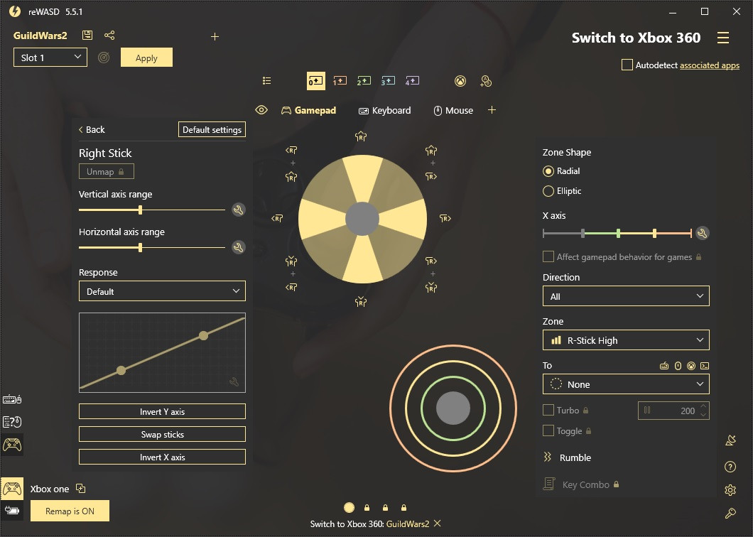

          Hi there,

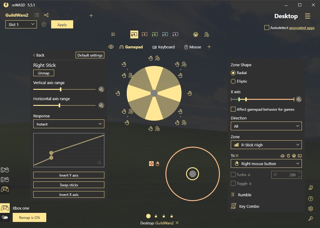

          According to the screenshot you have a medium zone left. Please, remove it as well to use high zone only - http://recordit.co/a0tjYyJhB5. In this case, the RMB (right-click, not left?) triggers only when the deflected stick passes the high zone.
          Also, try to use a default stick response curve.

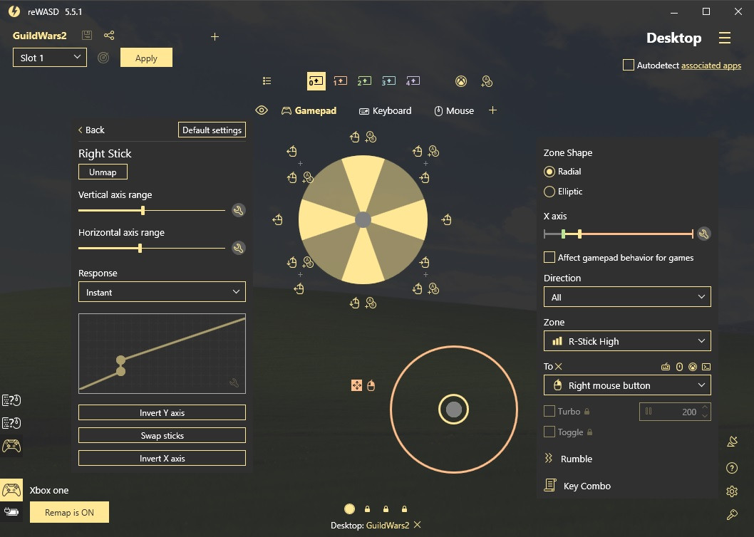

            Thanks for the info, I'm not sure I setup it up exactly like you said, it works a bit better, but the pointer still moves around, I dont know if I can take a video and upload it, but here is a updated pic, did I miss anything?

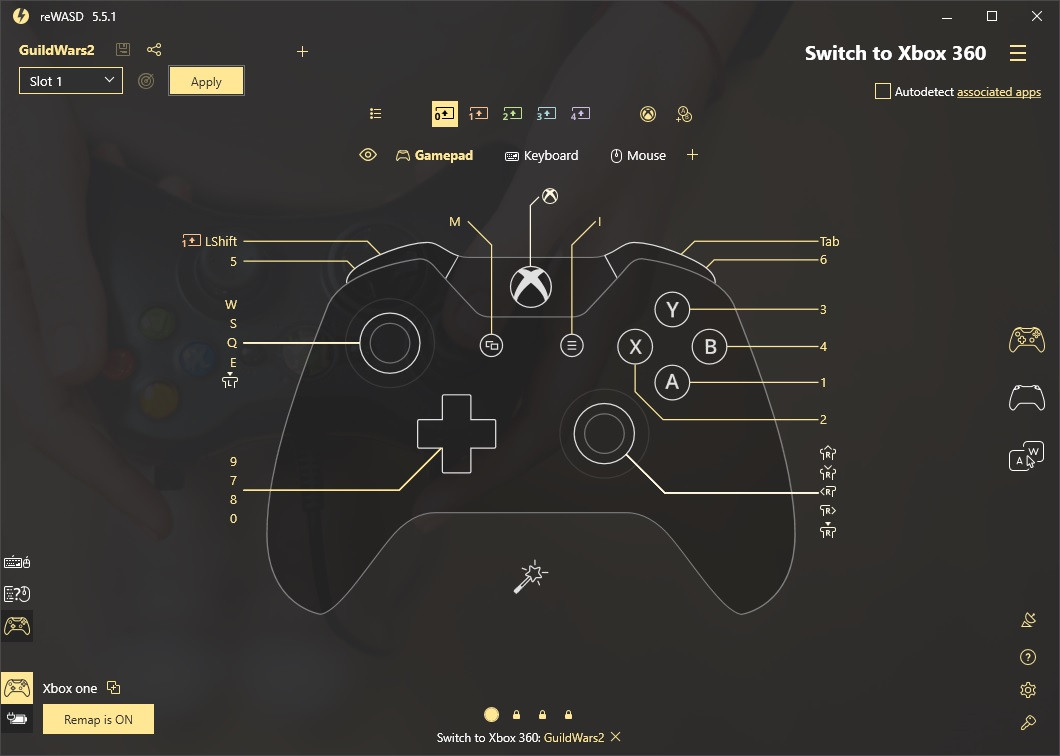

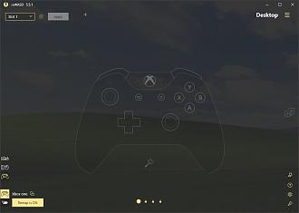

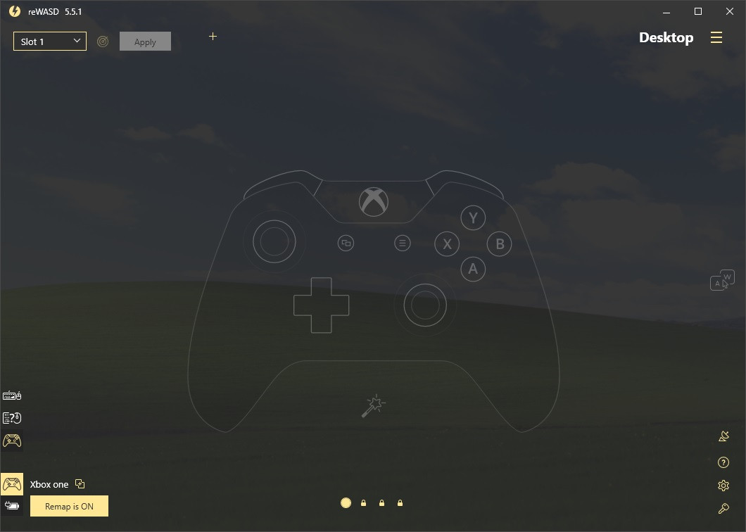

                Ok, So i reset my rewasd

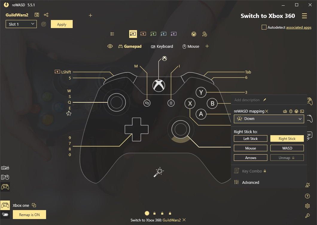

                I created a new config file and everything appears to be working correctly except the right stick, it doesnt move anything lol including the pointer which is what I was trying to get it to stop doing, so now I just need to program/set it up to only move the camera and that will be awesome, if its possible.
                I havent done anything to the right stick as I do not know what to do Any further help here would be greatly appreciated.

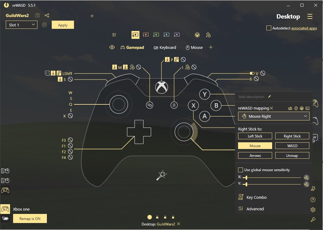

                  These are the right mouse settings

                    If you want the mouse to be moved, you should select the left stick and remap it to mouse.
                    Of course right stick does not work in Guild Wars 2 as it does not support a gamepad.
                    So you have to remake your right stick to mouse. But for this case, as camera movements needs your left mouse button to be held, so you have to assign some button for the left mouse click and hold it while moving the left stick.

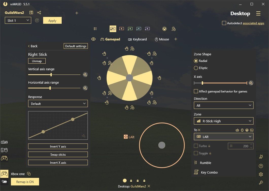

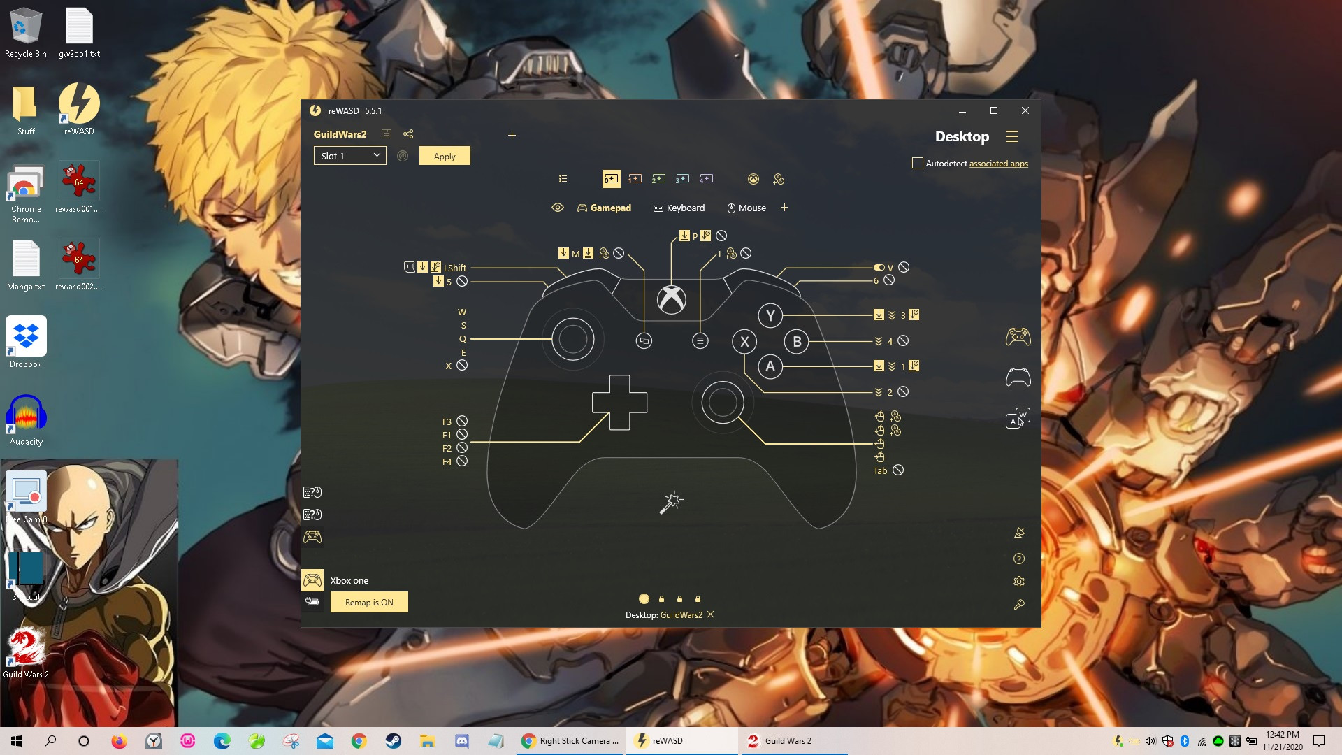

                      yes, I'm not sure how much you read, I copied someone else's guild wars 2 config file and im able to play the game pretty well for the most part, the config file allows the right stick to move as a camera, the left stick makes the character move around wasd or i specifically set it to wqse because i like the strafing, so i cannot change the left stick to make the mouse move, so the problem I run into is the right stick also moving the pointer around not just the camera, Star Lord asked me to make the config file from scratch, which I believe I did for the most part, but I do not know how to setup the right stick so that it moves the camera, let alone make it so that it moves the camera without moving the pointer lol, this is what I'm trying to get help with lol, i know trying to explain in text is difficult, I do have discord if anyone wants to talk we can do it that way lol
                      here is the pic of the config file that I copied showing how the right stick was setup, I want to replicate that or something similar so my right stick only moves the camera.

                          Well, as for me, if you mean mouse cursor as pointer, this happens because of how the game detect the input. Usually, when you move the camera, game should lock the cursor. But I guess this doesn't happen.
                          And you cannot stop the cursor of moving, because the camera will not turn then.
                          So basically, I just tested this config.
                          To rotate the camera, I have to press the left trigger to emulate the right mouse click and move the right stick (which is remapped to the mouse directions). After I release the left trigger, cursor remains at the same place.
