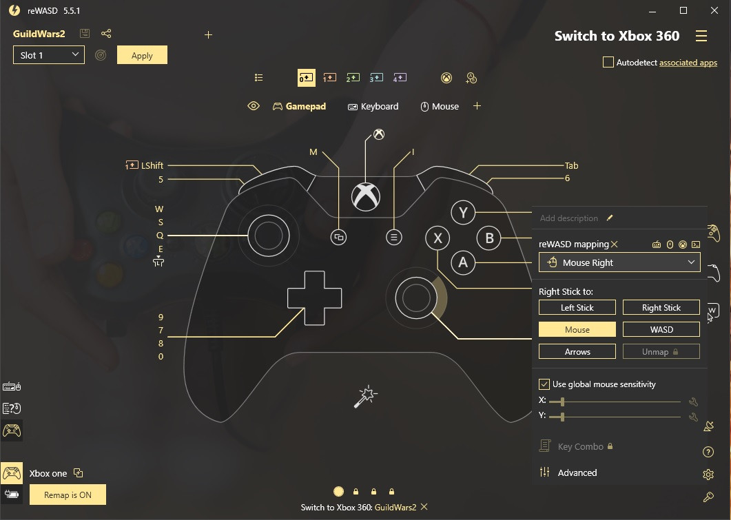

        ok i made a change in the setup for the right stick
        Now the right stick moves the camera, but there is still pointer movement
        All I did was change right to mouse.......
        I'm hoping some more tweaks will stop the pointer, or that is my goal anyways lol

          The config you are using is good, but you need to remove the medium zone, so that after the deadzone the stick goes to high zone immediately, and the high zone hold your mouse button.
          Here is how it should look like:
          Click image for larger version  Name:	e436e408ce.png Views:	0 Size:	357.8 KB ID:	222493
          Otherwise, I can check your config to be sure that it is set up correctly. Please send me the config you are using. Your configs are stored here: C:\Users\Public\Documents\reWASD\Profiles I need the correspondent *.rewasd file.

                I've updated the config a bit, please try it now.
                • #23
                  OK, after many attempts I think Ive finally come up with the exact movement(s) that I wanted to come up with for Guild Wars 2, I wanted to say thanks for all the help from the rewasd team, I did have to upgrade my basic rewasd account to full, however right now they are having a great black friday sale on the full account. (I'm not getting paid to say that lol, just wanted to show how appreciative I am with all the help
                  Here is my own config file from scratch if anyone has Guild Wars 2 and wants to test it out, you have to have toggle in order for it to work, and you have to press in the right stick to get the camera to move perfectly without the mouse/pointer getting in the way.
