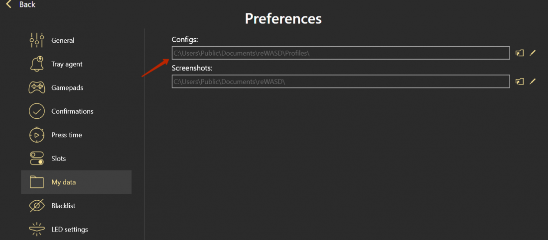

      Please go to Preferences -> My data tab and check the path you have for configs, like here:
      Which path do you see?

          Your case is similar to spoofer/cleaner usage aftermath.
          Please check the value of [Preferences > My data > Configs], as reWASDer asked. The value should be: *C:\Users\Public\Documents\reWASD\Profiles*. If it's *reWASD\Profiles*, use [this tool]. Once that is done, check if you have reWASD folder with profiles on your Desktop, and if you do, move or copy it to "C:\Users\Public\Documents\reWASD\Profiles".
          Then start reWASD, check if [Preferences > My data > Configs] value is correct and try to change config and [Apply] it again.

            Exactly same path as this photo
              In case the path is correct, please open General tab of Preferences and click Clear data button. Then, open reWASD again and initialize your devices from scratch. Try to Apply the config again and check whether the bindings are working now.
