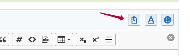

        It should be here, at the right above the post's toolbar:
        Do you have it?

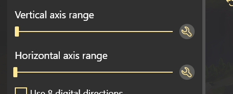

                      To make the mouse movement a bit smoother, please minimize the range of the axes here, in Advanced stick settings:

                        The D3D11 driver in UT was the problem. Used a D3D10 one and mouse movement is smooth. This PC is a 4790K so although it's more than capable, it's not as smooth as my 9700K build, of which all my profiles have been transferred to and all games run buttery smooth.
