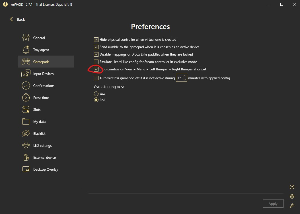

    reWASD has the emergency buttons Ctrl+Alt+Delete to stop remap anytime, and no mappings will be reproduced after pressing it.
    Also, you can stop all the currently running combos by pressing Menu+View+Left Bumper + Right Bumper.
      Arf, my apprehension was right then. It really felt like it was not doable from the tools i had. The stop combo is a good alternative on paper, but impossible in practice. I can't edit the shortcut (it's too long by default) and it would slow down reactivity of inputs on controller way too much anyway. Never mind, thanks for your answer. Do you know if it's possible that would be added one day? A way of simulating physical pressure on a button via a macro on another button. Or is it a bit too niche for that?

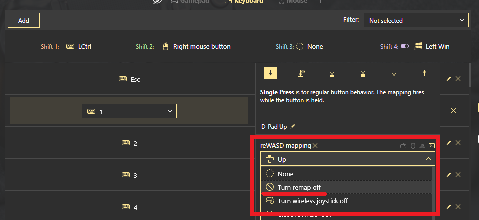

                    Also, there is a possibility to assign turning the remap off command to any button or combination of buttons you want. 'Turn remap OFF' is a command, available in the list of all the mappings.
                    Another thing we are working on, it was already mentioned in this topic, is making the shift layer to work as commands. So you can assign different actions of Shift mode to different keys. Stay tuned for updates on that feature
                      Interesting, thank you. Hmm, shifting layers doesn't seem to help in this situation as I just end up with a different layer with the same toggle still active from the previous layer, and then I can't disable the toggle because the num8 mouse bind I used to activate it isn't registered on that 2nd layer.
                      Unfortunately, the turn remap off command just minimizes the game and turns the entire remap off, requiring me to manually re-enable it in the rewasd app. I disabled notifications to try and stop it from minimizing the game but it still happens. Even if there's a fix for that, having to manually re-enable the entire remap every time is not practical for an ingame automovement solution.

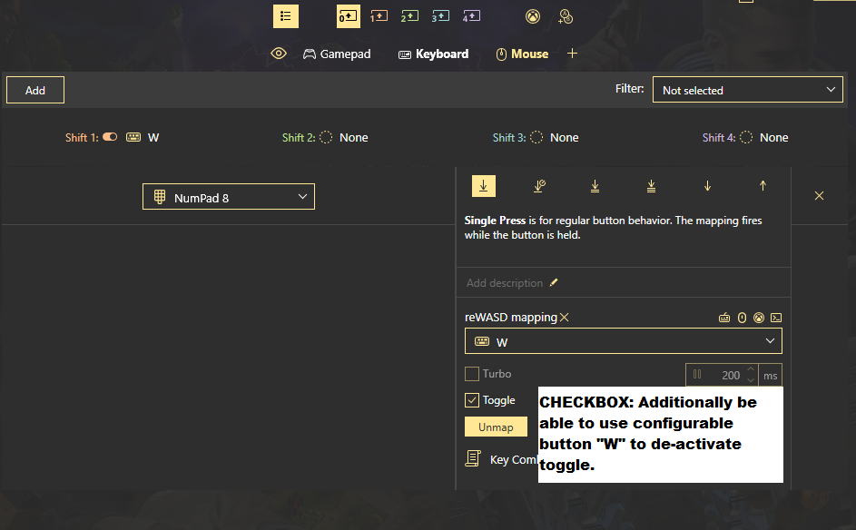

                              So this is mostly just a QoL request for an alternative way to easily disable and reenable toggles specifically regarding automovement in games.
                              I'm using a mouse thumb button (mouse numpad8) to activate the toggle. Ideally I just want to be able to alternatively deactivate the toggle which is holding down the W key by simply pressing/holding the W key again.
                              So basically, instead of being forced to press the mouse thumb button to stop the toggle and then haveing to follow up with pressing/holding W key after that to resume moving forward, I simply want to just be able to press or hold the W key again to deactivate the toggle and continue running forward manually.
                              Switching to another layer to potentially facilitate this was suggested by wookiepediologist, but I wasn't able to get it to do what I was seeking.
