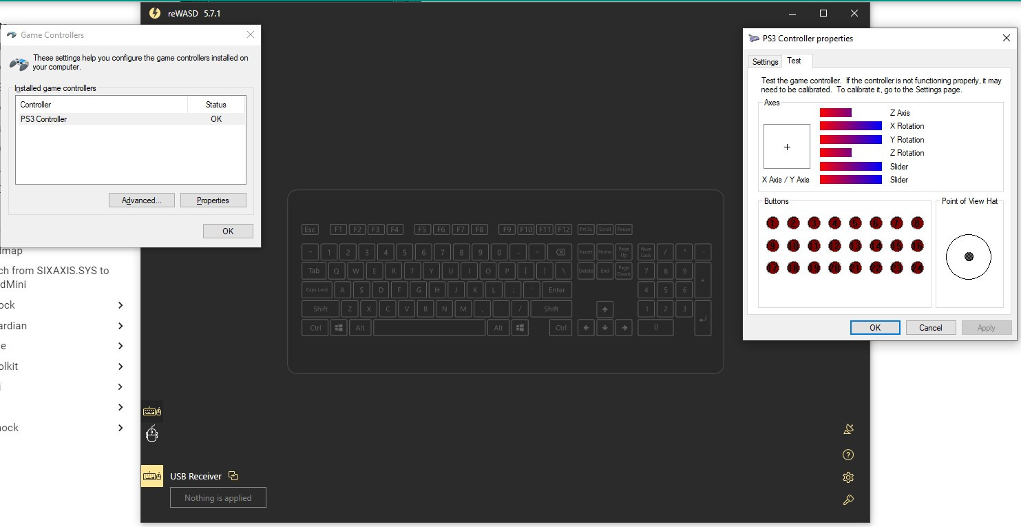

    I was using my new Dualshock 3 gamepad with default reWADS driver for long time and I thought that main features like pressure sensitive buttons and even analog triggers are not working properly in my device. But today I wanted to try some PS2/3 emulators where pressure sensitive buttons so started to search alternative drivers (hoping that it will help). And I was shocked. DsHidMini driver unlocked everything what was missing for my device in reWASD driver! Especially triggers (R2, L2)! Unfortunately, it locked possibility to use reWASD application - reWASD is not seeing device. Analog triggers are important for me, so probably I will stay with DsHidMini driver for longer time, especially that configuration works fine with Steam. But I don't want to stop using reWASD.
    And there is a question. Is it possible to make reWASD to work with DsHidMini driver (+BthPS3)? Or fix PS3 controller driver to recognize at least analog triggers (pressure sensitive buttons with soft/full press would be a dream, but probably it's not your aim now). Triggers with reWASD driver works for me like digital buttons with state 1 and 0, nothing in between.
    I am sending screenshots and logs, maybe it will help. I don't want to lose possibility of play with reWASD.
    Screenshot with reWASD driver:
    Screenshot after installing better drivers:Click image for larger version
ID:	226403 Thank you in advance!
    reWASD supports analog triggers of DS3. That is a big surprise that you have never used them with our app, oops. Also, we are planning to add support for the face buttons of DS3 (that are also analog).
    But, reWASD should be the only third-party driver for your device. Also, you need to install the native PS Now drivers — they will give you the analog behavior in joy.cpl, and it will STILL be usable in reWASD. But reWASD can still see analog triggers even without PS Now driver and no matter what you see in joy.cpl. joy.cpl reflects only what DirectInput games can see. But reWASD accesses device directly without DirectInput. Just test buttons and triggers in reWASD GUI and make sure they work. You will see "Zones" option in reWASD that indicates that we see the triggers as analog ones.
      Ah, thank you for explaining. Checked now and ReWASD is reading triggers signals properly. All works properly. My fault, I'm sorry for confusion.
      I was using joy.cpl as tester, but it seems that it's not good tool for doing this.
