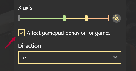

    "Please check Affect gamepad behavior for games option when you adjust the deadzone:"
    It really helped me, thanks!!!
    This one is required in order the deadzone is applied to the virtual stick.
    Then please re-check if the issue persists, and if yes, send me the config you are using, so we could re-check it from our side (right-click on the name of the config you're using to open the contextual menu, and choose Open file location; then send me the chosen *.rewasd file). Also, one more question: which physical controller do you use?
