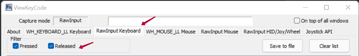

          Could you please try the same with this tool? It logs presses and releases of the keyboard keys, and it will help see the exact moment when it happens.
          If the download doesn't start, please copy the link to the new window. Once you open the tool, please switch to RawInput Keyboard tab and check "Released" too:

            I just tested your tool Input and input does look wrong. Instead of the W key (for example) being continuously pressed, it's being registered as multiple W presses that are delayed the longer you press. Another example in game.
                Actually, this part goes right — if you press and hold the keyboard key, you will see the same — there are lots of fast presses, and it should end with one "up" event — just "Released" option should be on in that tool.

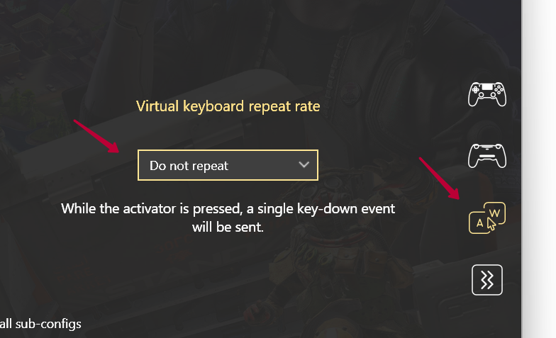

                You can switch this multiple emulation off in reWASD, you just need to set Keyboard repeat rate to Do not repeat here:
                Click image for larger version  Name:	44cb2220d5.png Views:	0 Size:	214.9 KB ID:	229833
                This part has not changed since reWASD 3.0 I think, so this should not be a problem.

                        Thanks, so I've changed the key repeat behavior, and all modes seem to work correctly (Slow, no Repeat and Keyboard Native), so the problem seems to be with the 'Fast' repeat mode. I'm on Windows 11, if that makes any difference, so that would fix my issue, but I do think there is something wrong with the 'fast' mode.
