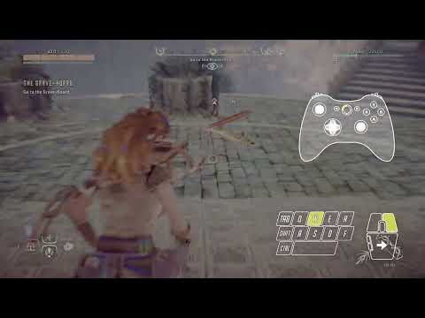

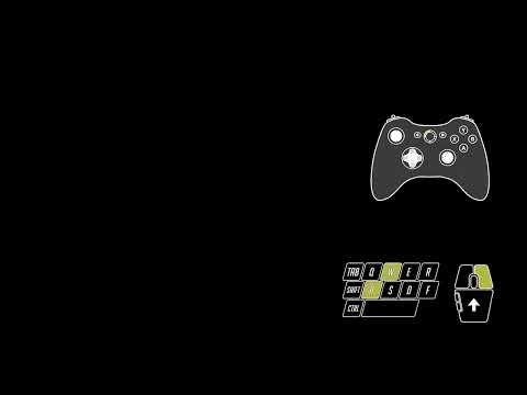

                  This is definitely a bug with rewasd, I can fully reproduce in game or outside game, using OBS to capture, I'm attaching videos to show the issue. My config is as follows:
                  - A normal xbox or ds4 profile, where the left trigger is mapped to right mouse click (which is meant to aim in game), and is also a shift layer that changes the controller to be completely a mouse and keyboard setup. If I press Left trigger (right mouse button click) and hold, while walking with the left stick (mapped to WASD) and aiming with the right stick (which is mapped to mouse in the shift layer), and I release the left trigger, taking me back to the base controller layer, the WASD keys stay pressed for some time (and that happens even after fully releasing the left stick and receiving not input.
                  From my videos note: There is no mouse or keyboard, it's only the input from the rewasd mapped gamepad being shown. One is while playing, the other is just using the controller in the desktop. The WASD input should only be happening (and is only happening) in my example video while I'm holding down the Right mouse click (which is really the left trigger), but for some reason the keys are left pressed even after stopping all input and going back to the base layer.

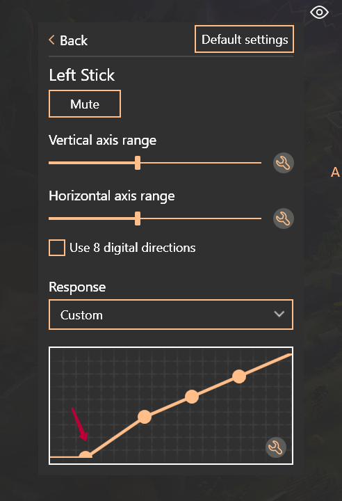

                        Could you please try to make a bigger deadzone in the Shift layer (using Response curve where the first dot should be placed on X axis) and try it again on your side?

                            I tried your response curve and it's still resulting in sticky keys with all configs and all controllers. Something is really broken with stick - wasd mappings.
