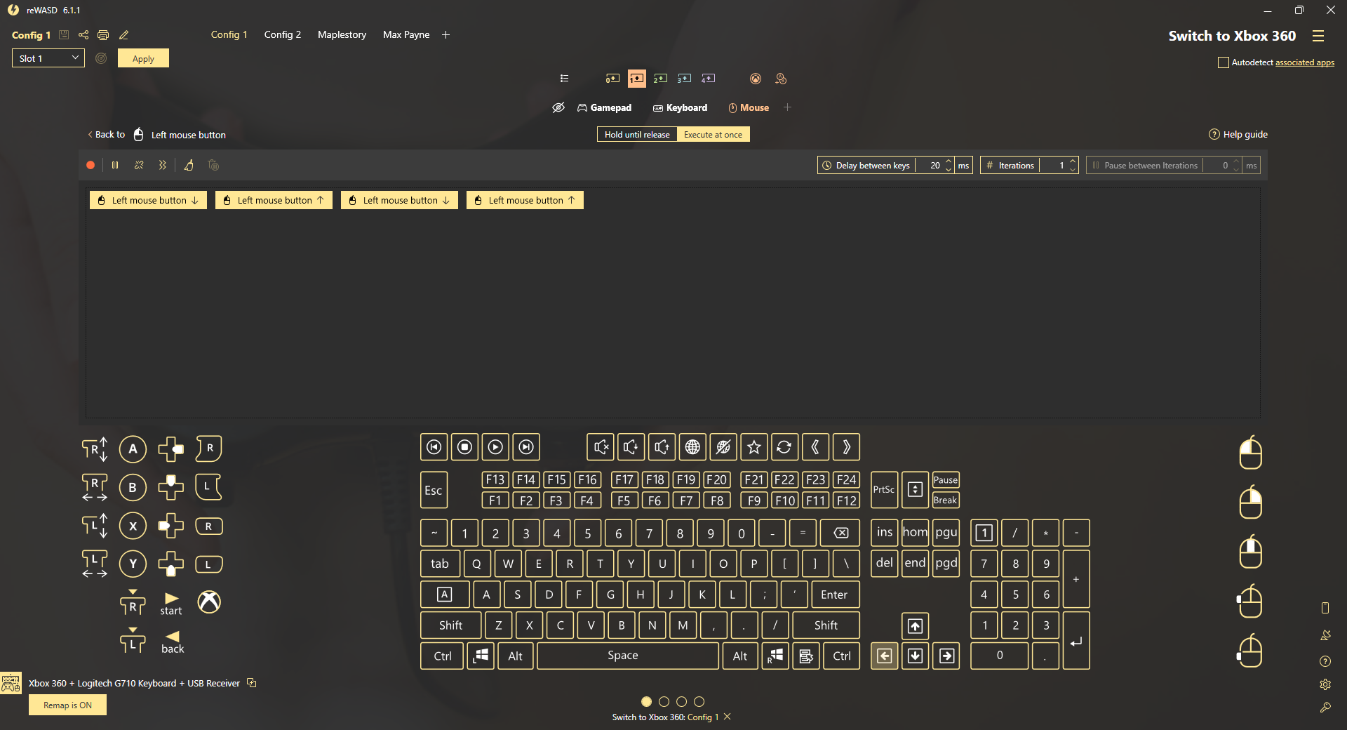

    Hello. This is an amazing software. Everything has been working good for me so far when it comes to macros on a controller. However, when it comes to fps games and I try to add turbo to my clicks, its kind of a hit or miss. An example would be Far Cry 6. When I add rapid fire to my right click, it lags in certain areas of the game. I would hold down the left mouse button and the gun would fire a few rounds, stop, then continue. I've tried to play with pauses in between but its still not as smooth. I'm wondering if I'm doing something wrong. Here is an example of what I try to mess around with:Click image for larger version
    This is just one of many variants i test with. I've tried to add micro pauses between each click, I've also tried to add several clicks to the combo. It seems to be more stable with more clicks add, but still not as smooth. Thank you

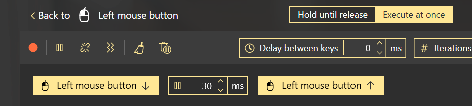

    If you get inconsistent behavior, it seems that the game doesn't detect such a fast click. It may be a good idea to experiment with pauses. I would suggest that you create a combo that looks this way:
    With this combo, you can set a pause that will determinate how long the button is pressed. Please try 30-40-50 ms and check in-game results.

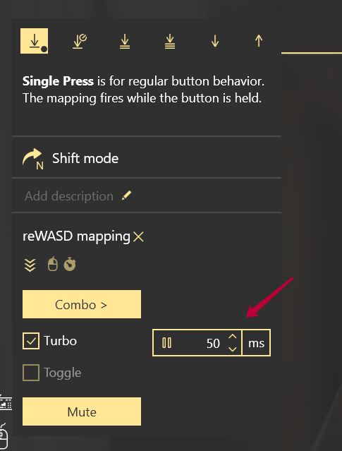

    Then, this combo can be set to Turbo, and here we have one more pause — it determinates the time between clicks (shots). For different guns, this pause could be also different. If you use some "heavy" weapon, I would suggest increase the pause between shots:
    As I can see from your screenshots, you have used 20 ms in both cases. I assume it may be not enough.
