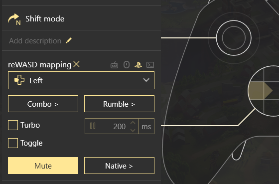

    3. This problem can be solved if you add a Mute to the dpad key and remap it to the same value. We will fix this in a future update.

      1. Long press is triggered when a key is released, if other mappings are set on it (double press, start press, etc.). This is a feature that allows it not to conflict with other mappings on that button. Remove them and it will work immediately.
      2. This can be done using shortcuts. Create a Tap shortcut on the desired touchpad zone + Touchpad Click.

      Thank you! The dpad and touchpad click/touch are working as expected now.

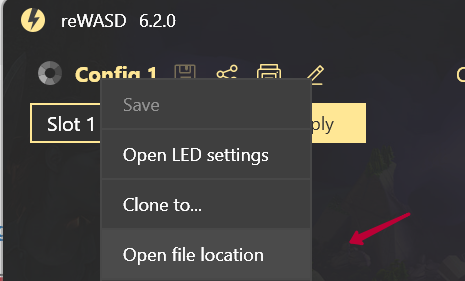

                Please send me the config with your setup for Home which doesn't work as expected. I am trying to repeat the same behavior but I can't — the Long Press mapping works after Long Press time finished, no need to release the finger. The easiest way to get a config is to use the context menu here:
