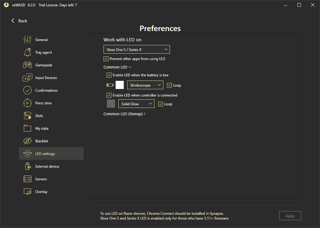

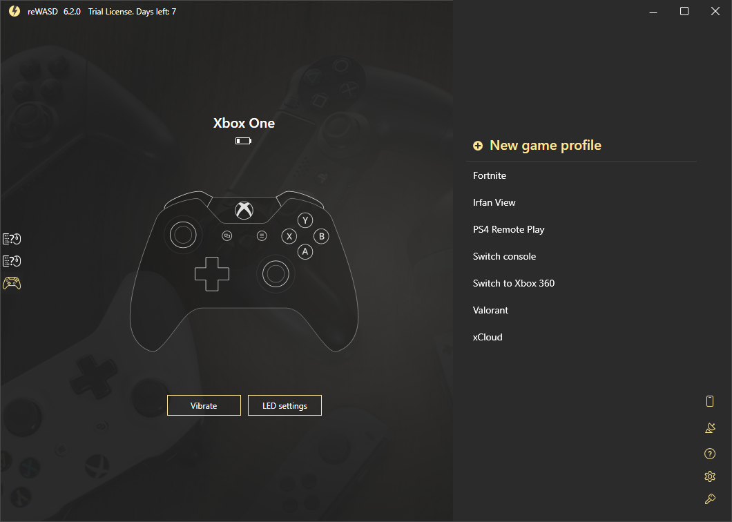

    Hey there. I'm having a issue with the reWASD LED feature on the Xbox One controller model 1708 M1008260-007. I'm still on trial period and consider buying the software after that. Also English is not my native language, so I ask for a bit of patience if I didn't explain things right.
    I've set up reWASD to blink the controller's LED (stroboscope pattern, max bright) when battery level is low, but it won't work.
    I get both the low battery popups ("The battery is Low. Isn't it time to charge it?") and the critical battery popup ("The battery is Critical. You are in danger!"), but the controller's LED doesn't change even though I have set it up to in the led settings. All blinking patterns for "Enable led when controller is connected" work (solid glow, shimmer, heartbeat, stroboscope and breath) with different light intensities, but only for it. The blinking patter doesn't change when the battery level is low nor when it's critical.
    I've tried:
    -Restarting my PC. No effect
    -Update the controller firmware (now it is version 5.13.3143.0), but only the "Enable led when controller is connected" feature work.
    -Test different brightness levels. They only work for the "Enable led when controller is connected" feature.
    -Unmark the "Enable led when controller is connected" box, but it only leave the LED turned off, and doesn't do anything when battery level is low or critical
    -Unmark the "Loop" box for "controller connected", but the led only work for a few seconds then turn off (but the controller is still on)
    -Unmark "Loop" box for "low battery". No effect
    -I've also tested all combinations mentioned above with both the "Enable LED on remap and shift changing" and "Prevent other apps from using LED" boxes marked and unmarked but it makes no difference. If Remap is enabled, then only the Remap LED configuration stays enabled.
    -Connecting by bluetooth or the Xbox wireless connector makes no difference.
    I wonder if the issue is if that my controller is old (I bought it in 2017) or if it's software related. I think maybe the "low battery" setting is getting overriden by the other ones, or maybe there's a bug that prevent it from working properly.

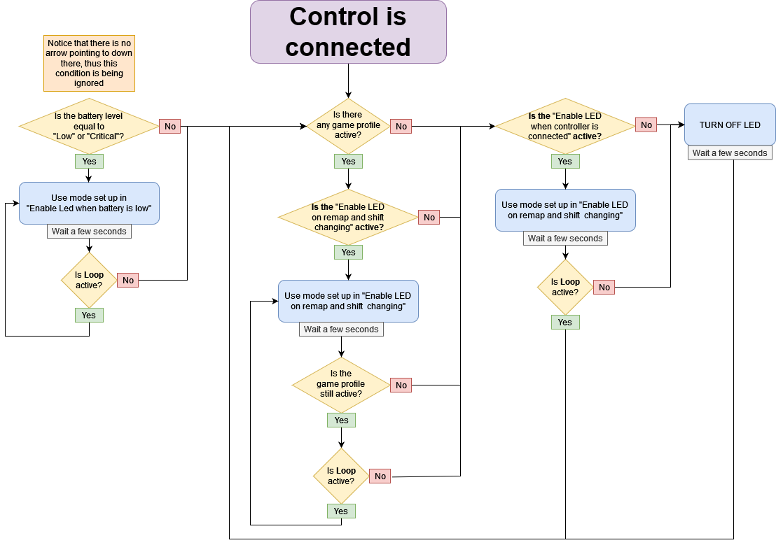

      Further explaining about the problem only would result in a giant text and confusion, so instead I made this diagram with how the software is behaving with me to try to make it more understandable. Hope it helps.

        Thank you very much for the details. I will let you know the results of our tests soon. Unfortunately, all our controllers appear to be fully-charged, so I may need some time
        Also, I forgot to mention before that I use rechargeable AA batteries on the Xbox Controller instead of the "Xbox Charge and Play" battery. It only gives the remaining battery level as "Full", "Medium", "Low" or "Critical", but it gives no clue of percentage left.
        There is nothing wrong, Xbox One controller indeed reports only the mentioned battery states. It is not possible to get the percentages for the battery. Also, everything should work with AA batteries, so it should not be the reason. Will get back to you once we have any news!
