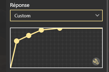

        Looks like the stick is not deflected far enough while you are trying to make gentle moves. In your current config, please try to raise the first dots on the Response curve to get the bigger deflection. Something like I have here:

          Hey! I think that was it! I just needed to move the 1st dot a little bit more to the left and up.
          A tiny bit more fine tuning and I think this'll be perfect for my needs. Thanks so much for the help!
