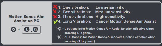

      Originally Posted by WilliamTael View Post
      I suggest disabling the ZL gyro activator function.
      I am not sure if I understood you. Are you about this calibration or something else?
      At the moment, we are checking the raw input of the device, without any other remappers or emulators.

        Can you rephrase that or explain it in more details, please?
        There's an option o Steam controller settings that you can click on the gyro symbol and set it to work as a mouse.
        Map the other control buttons to keyboard keys and use HidHide to hide the controller buttons from being detected on the game you're going to launch via Steam.
        That way you can test the gyro as a mouse on games that don't support gyro and compare how well this gyro to mouse conversion works on Steam and on ReWASD (with Steam closed).
        • #34
          No. I meant there's an option on the controller manual that says how you can change gyro sensitivity.
          Ok, no emulators at this moment, I got it. Try Steam and map the gyro to mouse with buttons to keyboard keys, using HidHide to prevent the game from detecting the real controller.
          That way you'll see the difference on how gyro behaves on Steam and then ReWASD.
          • #35
            Thank you for the tip, will try to change the sensitivity this way.
            We do not test other apps because we already understand right now that we see the gyro with abnormal sensitivity. We will try to find the workaround for this case. Stay tuned to the updates
