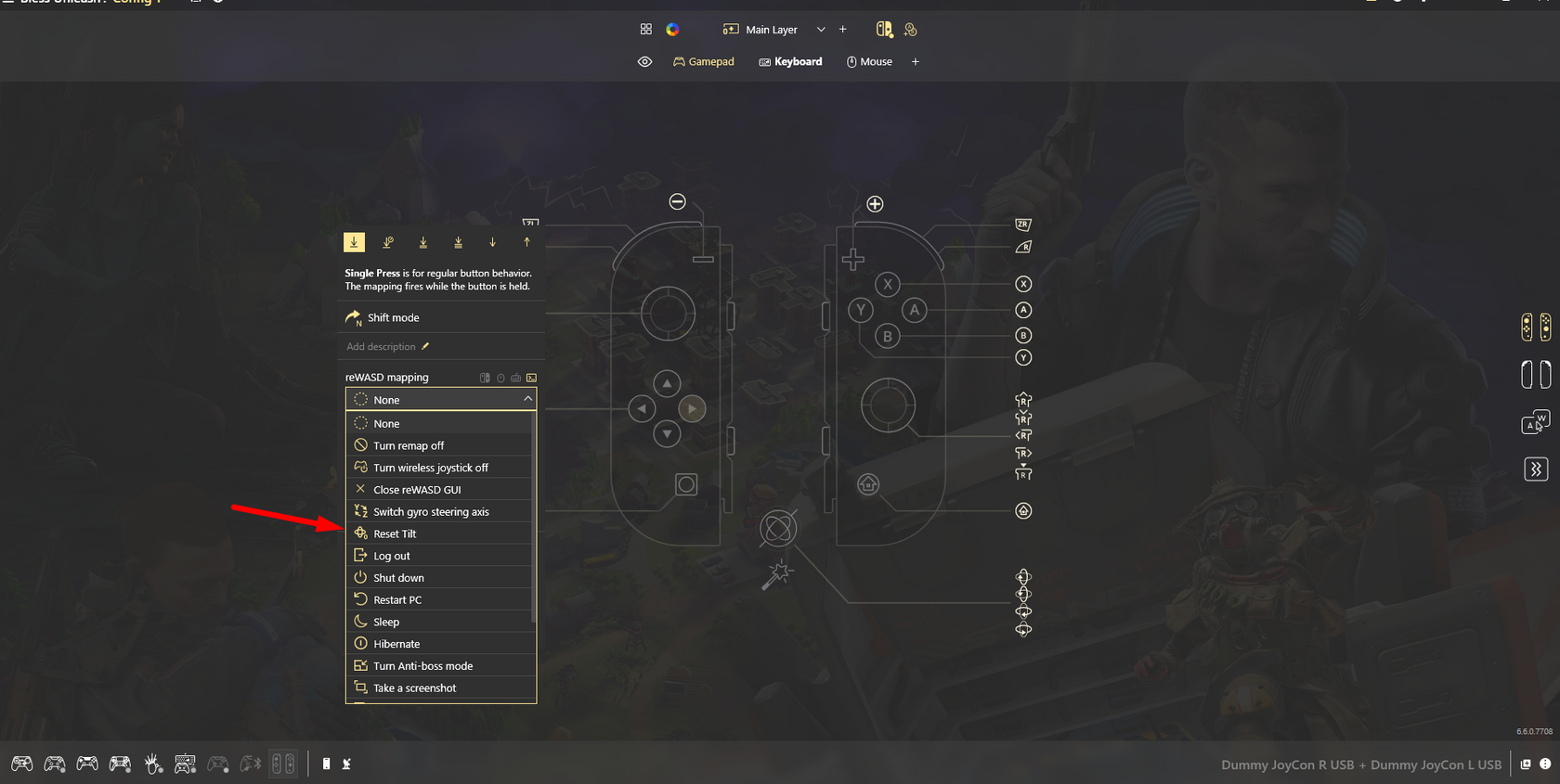

                              Santi-Tetra
                              Hello again
                              I've doubled checked info about swapping the yaw and roll axes on a Joy-Con controller with guys from reWASD, and I was informed that this option really doesn't work in Tilt mode. I guess that it will be added some notification in the GUI that this option is not working.
                              However, if you are using tilt mode, the Reset Tilt command must be applied when changing the position of the gamepad from horizontal to vertical (and back again)
                              You can add this common to any key of your joycon ​
