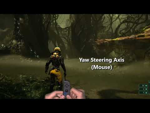

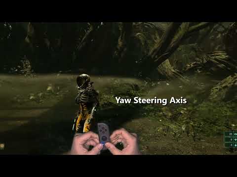

    Hey, I realized the video I sent was using gyro to mouse, not Gamepad like your videos. So I wanted to go check and see if I can recreate the issue you have and you are right the steering axis does not work for Yaw when using gamepad input. I have made some videos to show this bug. All of this is using official Switch JoyCon.

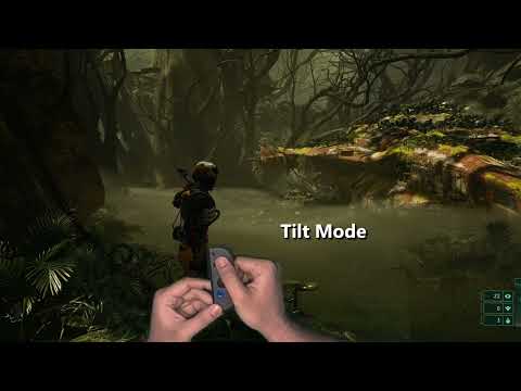

    First off, here is a video showing the difference between Gyro mode and Tilt mode as I think it may help you with what you are trying to do​
    As you can see, in Gyro mode every movement gets sent as it's own input and it is not continuous unless you continue moving. In Tilt mode it continually gives input as long as you tilt away from the 'center point' like an analog stick does. The center point is the position the JoyCon is in when gyro is turned on, for this reason I think it is helpful to have a button mapped to 'Toggle Gyro On/Off' so you can easily set a new 'center' point if neccessary.
    Ok here is the video showing the issue:
    First I show that reWASD has it's Gyro Steering Axis set to Roll, and in game it works correctly with Roll giving right to left movement. Pitch is inverted but still works correctly(can be easily fixed in reWASD), and Yaw gives no input at all.
    Then I go back to reWASD and switch Gyro Steering Axis to Yaw and go back into the game and you can see everything is exactly the same. Roll gives left-right X-axis movement, and Yaw still does nothing and gives no input.​
    Then I went back and made another config using Gyro to Mouse to see if it has the same issue, and Mouse does not have the same problem.
    Here I show that when using a mouse config, both Yaw and Roll Steering Axis work correctly.
    So the issue is that when using Xinput gamepad config the Yaw / Roll Steering toggle does not work, it is always on Roll regardless of what is set.
    I think this is a reWASD bug so hopefully it can be fixed.​
    I have attached both configs I used to do these tests

    In this video I show you how behaves in my game the "gyro" mode vs "tilt" mode. As you can see, I think the "tilt" mode is better suited to my intention to trotte and brake. I've, however, to test it more thoroughly, because when I made the video, I realized that I had the axes confused in my mind.

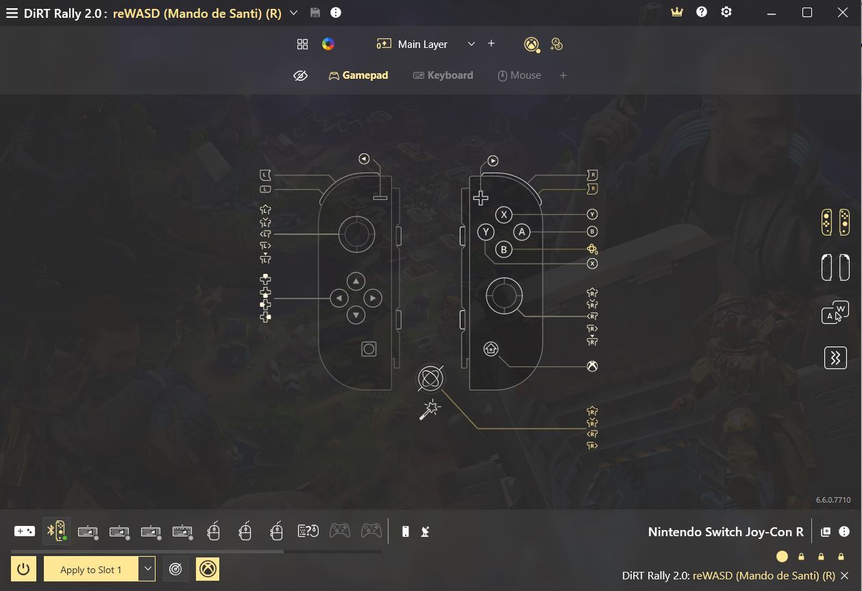

                      Of course. I think it's this file, right? I attach an image of my reWASD to confirm it.
