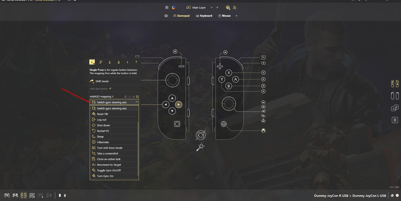

                            I would like to start with the fact that you don't need to go to Preferences every time and change this parameter. As I mentioned before, we have a special command for this action.

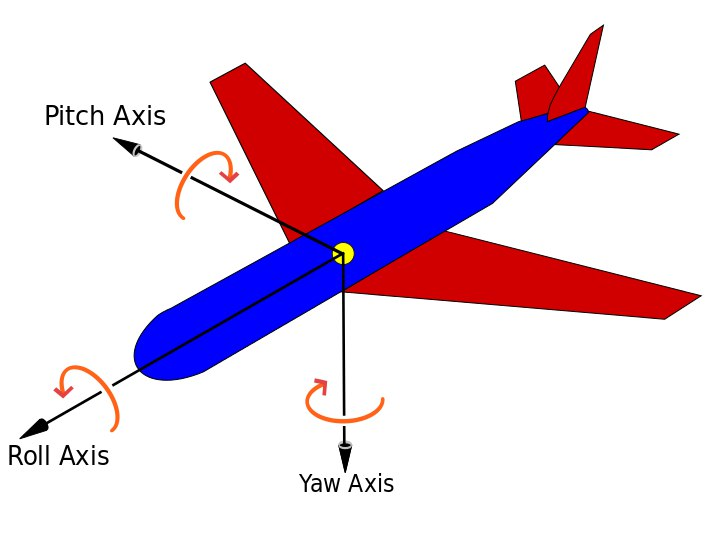

                            Then, I will try to clear the air with "Yaw" and "Roll" modes. So, based on your first video, where you adjusted Yaw mode and tilted the controller forwards and backward, it seems that X-axis doesn't work. but it should not work in this mode, as you should tilt the controller as a steering wheel in this case.
                            After you have changed the mode to Roll, you start to tilt the controller as a steering wheel, but in this mode, you already need just tilt the controller.
                            The gyroscope may also be inoperative if you accidentally hit the axis
                            I also added the picture that might help to figure it out how it works in reWASD
                            I suggest setting up the mode in the Preferences and leaving from that page. Then, add the command and switch between modes on the fly. I guess that the difference will be more clearly
