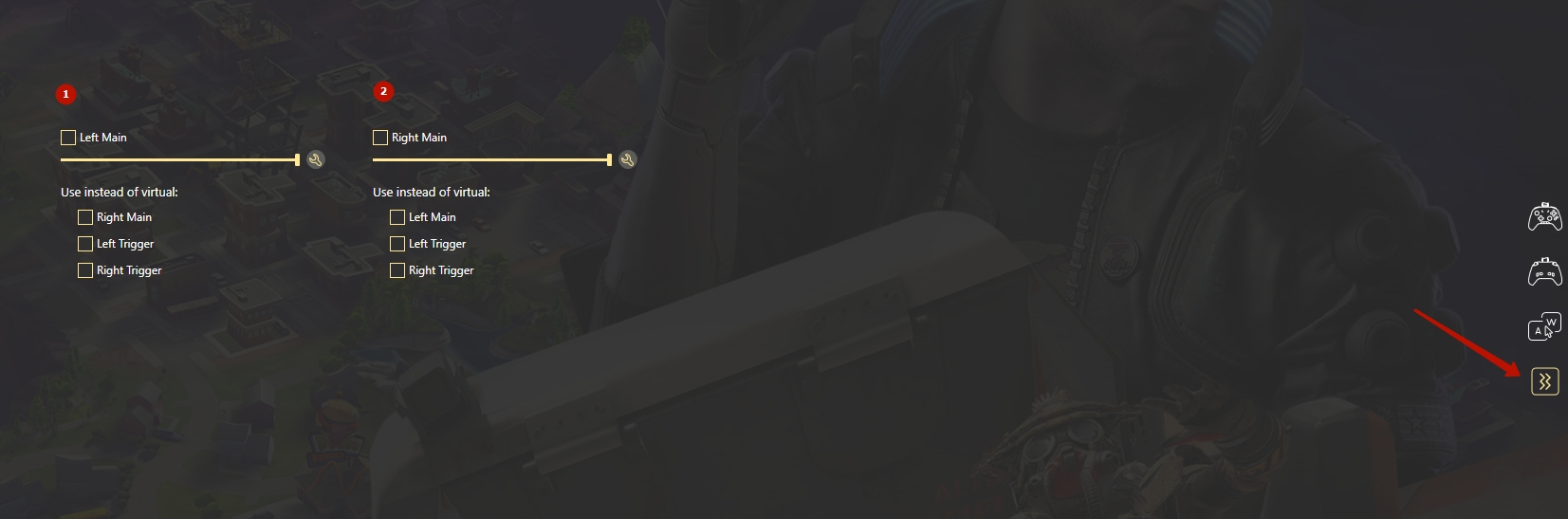

        I think I know how to turn off the LED in rewasd, is there also a setting to disable rumble support in rewasd?
        • #19
          You can turn off the motors for the emulated virtual controller in the vibration settings.
