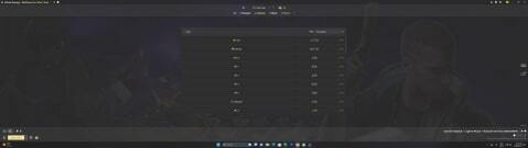

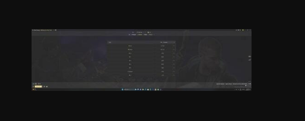

              Hi. Please send us a screenshot of the full reWASD window with your mappings.
                Thank you for the reply!
                  Unfortunately, nothing is visible in the screenshot you sent.
                  Please send a correct copy of the screenshot.​
                    How about this? Click image for larger version
                      Your screenshot looks something like this, and nothing is visible on it.
                      Please make the reWASD window a little smaller, then take a screenshot by clicking on the active reWASD window and using the shortcut [Alt]+[PrScr] and [CTRL]+[V].​
                      Click image for larger version  Name:	image.png Views:	1 Size:	36.3 KB ID:	239248

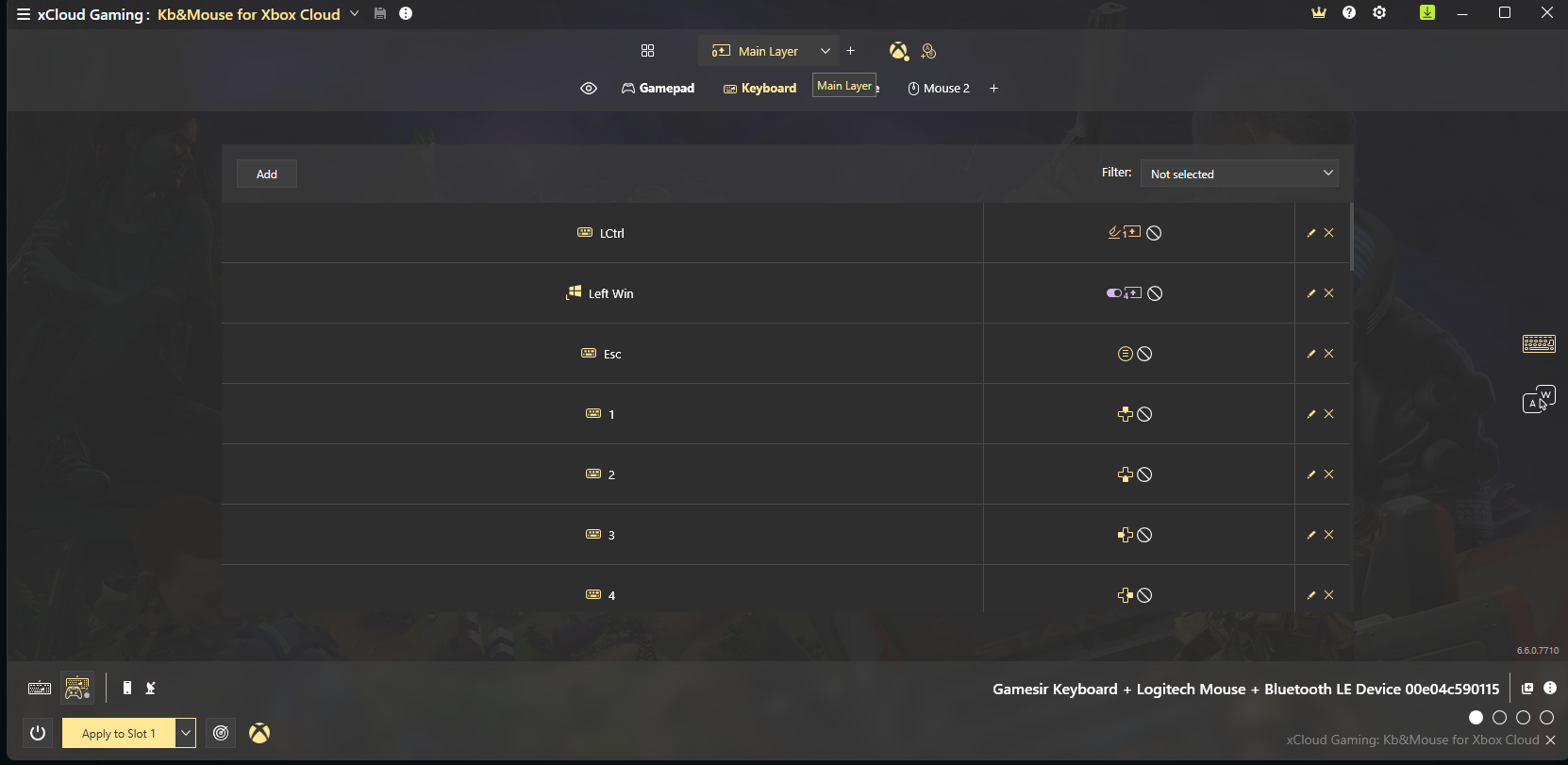

                        We need to see whether your devices are grouped correctly and to which group of devices the config is applied.
                        Please send us a screenshot.​
Name:	Screenshot 2023-09-12 205012.png
ID:	239252 My apologies, hopefully you can view this better.
                            Please apply the config and check if it works correctly in the tester: https://hardwaretester.com/gamepad
