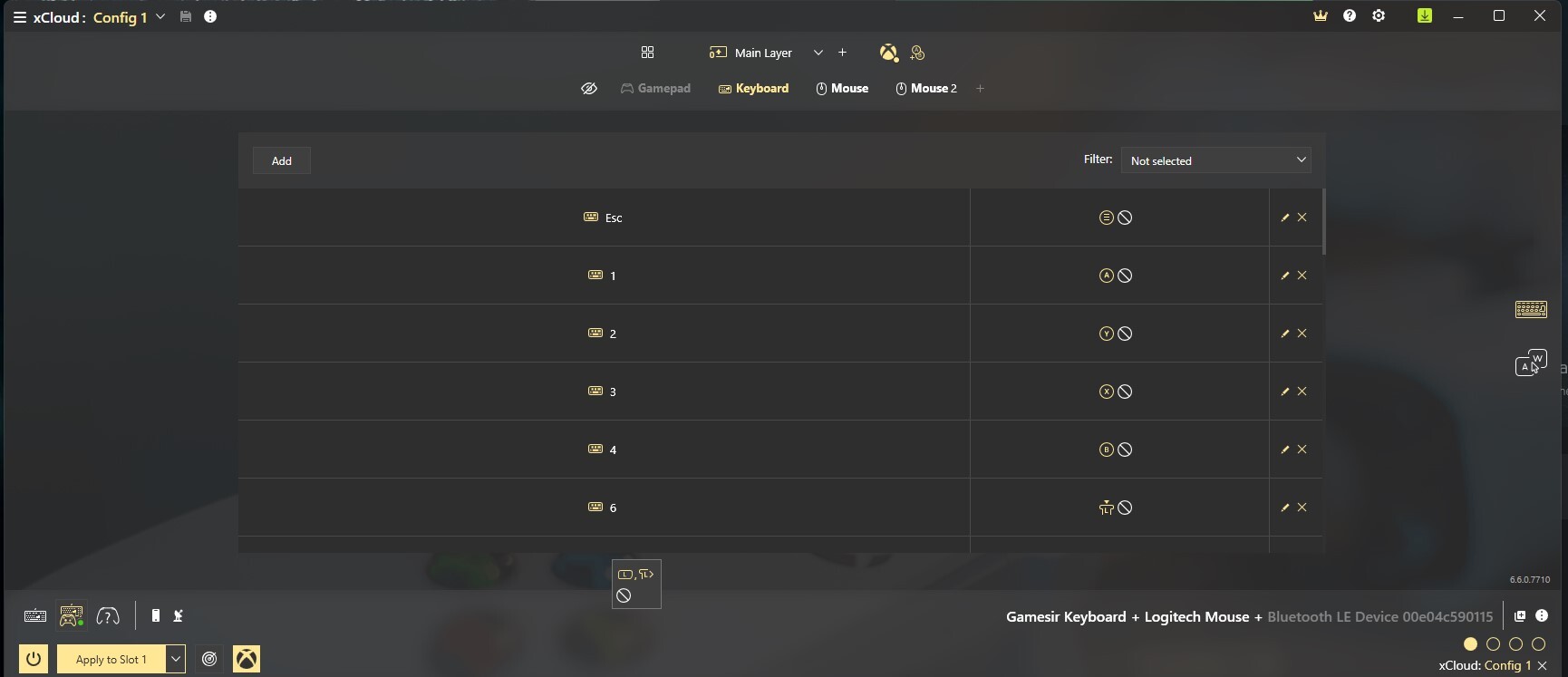

      Please first apply the config and check if the mappings work in the tester, as we asked you several times earlier.
      • #18
        Not a problem.
        I have done so and when I turn on Rewasd, both the game sir and Xbox controller connect.
        • #19
          So yes the keys are working.

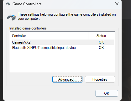

                    Also, I would be glad if you send a screenshot of joy.cpl after applying the config.
                    • #25
                      Hey man,
                      Unfortunately I do not have another virtual controller that I can try and test.
                      And, the xcloud app used to play quite easily but now there is no response at all.
                      Please find attached image of joy.cpl

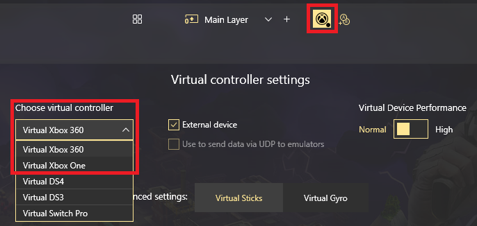

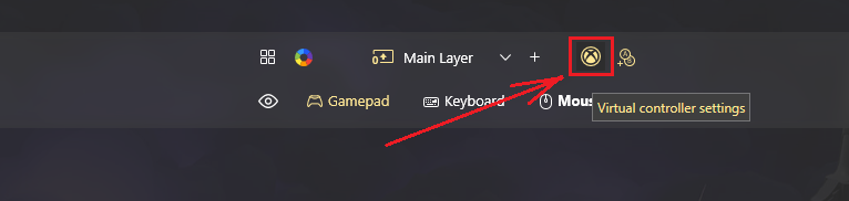

                        • #27
                          You need to go to the Virtual Controller settings and try changing the selected virtual controller to another Xbox controller. As shown in the screenshot above. Perhaps this will help solve the issue.
                          Please don't forget to re-apply the config for the changes to take effect.

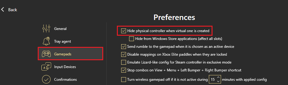

                          Also, you need to go to Preferences, select the Gamepads section, and ensure that the "Hide physical controller when virtual one is created" is checked.​

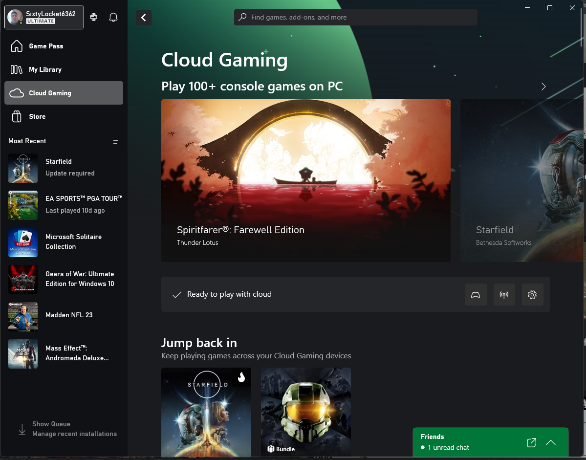

                            So, when I connect my rewasd my Xbox app recognises my keyboard and mouse as a controller yet I'm getting no response on my Xbox console while I use the inbuilt x cloud from rewasd, it makes no sense.
                            I apologise if it feels like I'm carrying on but I really want to play starfield on my Xbox console.
