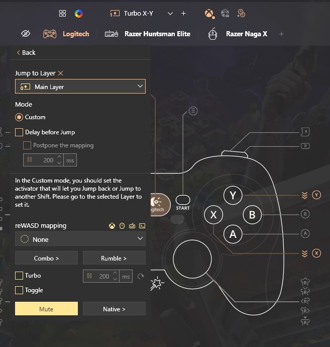

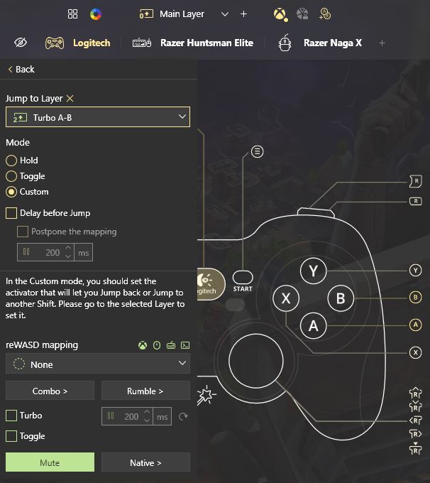

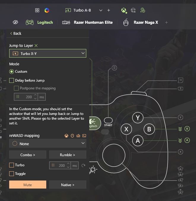

    I'm trying to get my Logitech F310 to cycle shift modes. Pushing the logitech button I have that set to from layer 0 to layer 1 to layer 2 to layer 0. Each time I push that button, it should cycle the layer from one to the next and back to the beginning each time I push it.
    See screenshots below as it goes from Main Layer to Turbo AB to Turbo XY to Main Layer, each time I push that button. This seems like it should work, but it doesn't.

                You are missing the Custom Shift jump mapping from the 2nd to the 3rd layer in this config.
                  Yeah, I had to remove it because it didn't work. I've put it back on and here's the config, which doesn't work (tested again).
