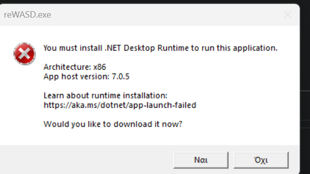

                      Good morning, I have the program it says, but it doesn't open and it says this, what should I do?
                        Hi mitsos1987
                        As stated in the notice, you need to download and install the latest version of .NET for reWASD to work correctly.
                        .NET Core is an open-source framework developed by Microsoft for building modern, high-performance applications.
                        For proper functionality, reWASD necessitates at least .NET Core7.0.5
                          I have put them but nothing comes out the same
                            mitsos1987 Please install these two frameworks manually:

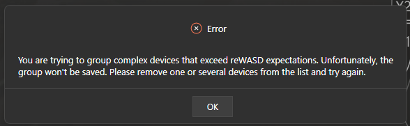

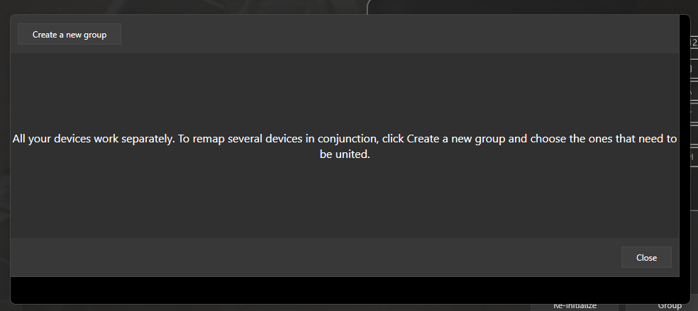

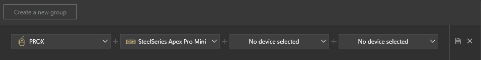

                              Hi, i have a SteelSeries Apex Pro Mini and when i try to group it with my mouse i end up with those messages and it's not working. Anyone has the same Keyboard as me or have already got this error? The two first picture are when a try to group from my mouse and the last one is when i try from the keyboard i get this for 3 sec on my screen and then rewasd close.
