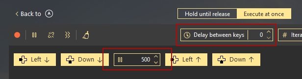

    Please add support for diagonal inputs, to be used in [Execute at once].
    No matter how you rearrange the arrows, it still comes out wrong! :^(

    1. Could you please describe more how do you want to use the diagonal inputs? In which game, for which action? The first things that I can see according to your screen is that you press left-down and release left-down immediately. The game may not be able to detect those actions at all. I would suggest you to add delay (pause) between "downs" and "ups". But we'd better try it in game to find the perfect solution.

      Yeah, I've been trying for more than 8 hours with all types of settings, including adding pause between keys.
      If it had a input recorder, this would be alot easier to program.

        1. Here is one more thing that comes to mind. You have "20 ms" delay between keys that is added to any nodes in macro sequence. Seems that this delay allows the game to see the left and down actions separately. Here is the mappings I've done: Delay between keys is set to 0, pause is added. The pause is pretty long in my case — it allows me to see the input in joy.cpl. If you could share that game you use it for, we will try it in action to be sure.

          Tekken Tag 2 on the PS3 emulator. When in Practice Mode, pause the game, then go to...
          Advanced Settings
          HUD Info.
          Command History <ON>
            Thanks! Adding "0 delay + Pause" worked!! :^)
