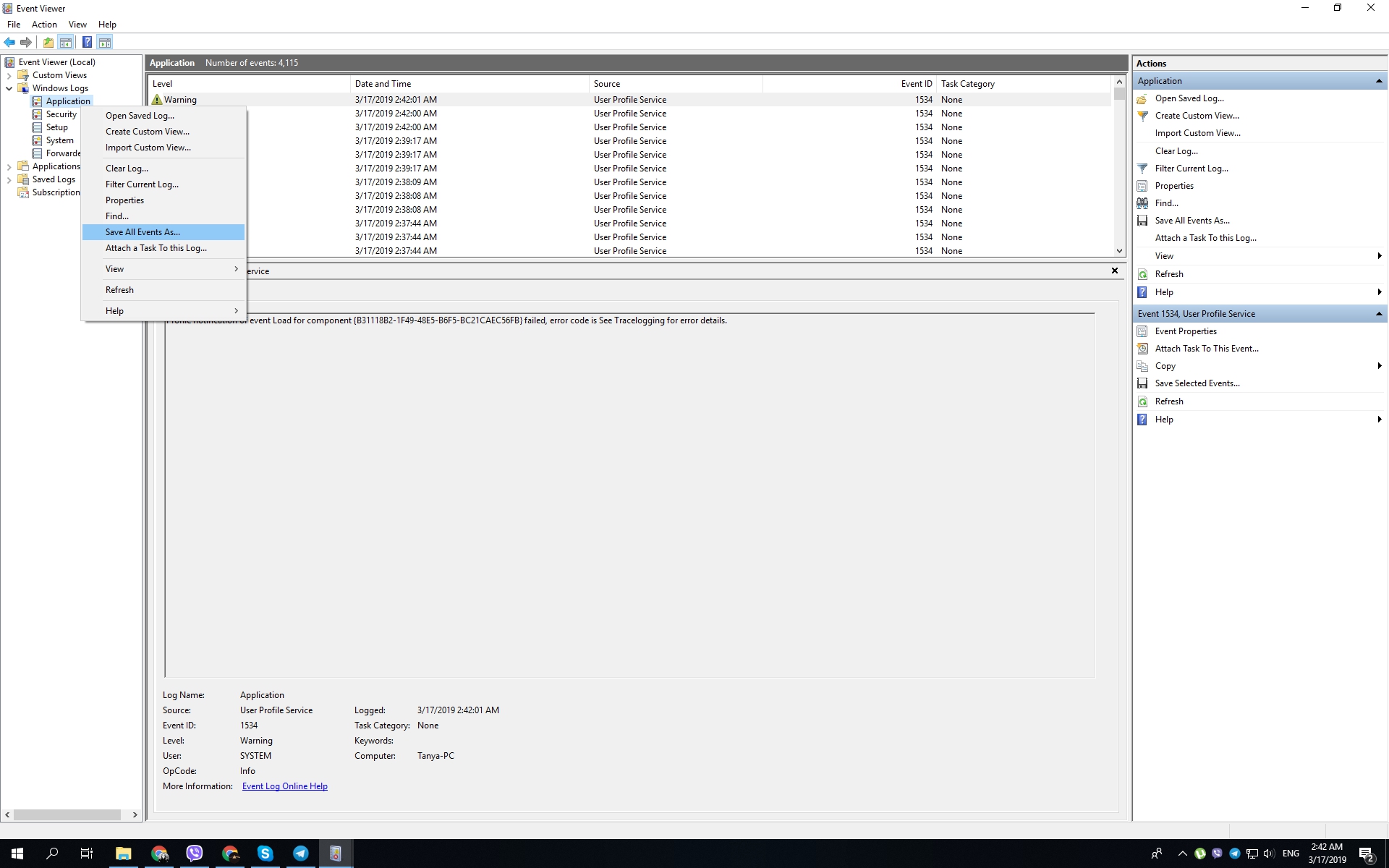

                  I need to ask you one more thing.
                  Could you please type Event Viewer in the Windows menu and save two files with logs: for Application and System sections in Windows Logs?
                  Please send them to support-eml@disc-soft.com too.
