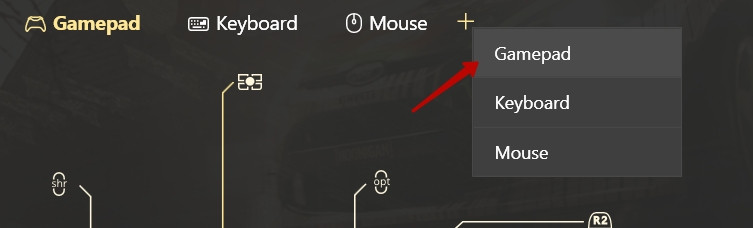

          In regards to gyro for joy-cons, I'd like the option to have separate gyro options on both when they are linked together.
          You can do it if you create two sub-configs for your grouped Joy-Cons and map them separately. Both ones should have "Gamepad" type:

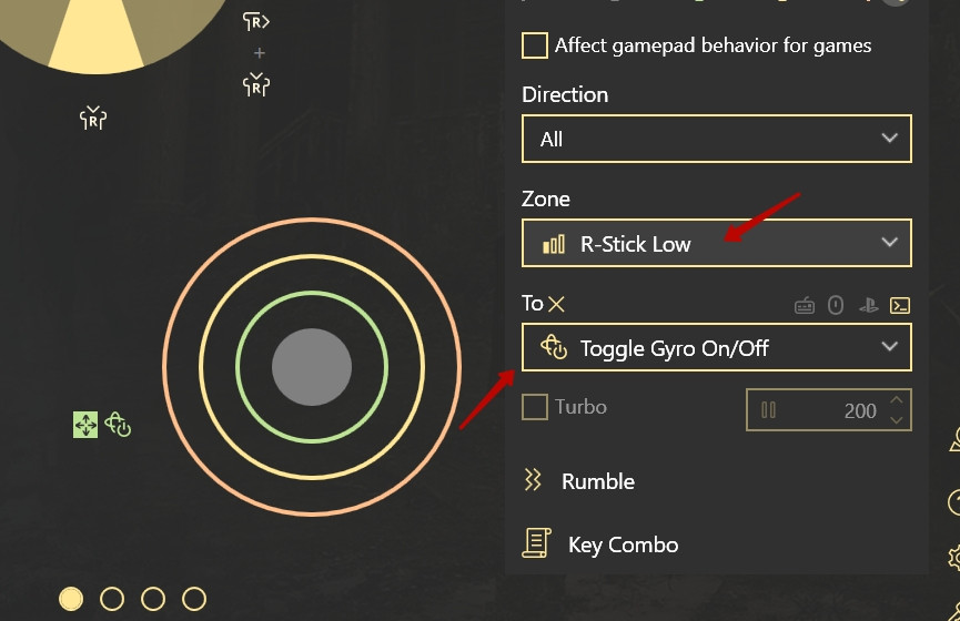

          an option to temporarily disable gyro when moving the right(and maybe left) analog stick
          There is a kind of workaround for this case. Go to Advanced settings for a Stick and map Toggle Gyro On/Off command to the Low zone of the selected stick. Once you start deflecting a stick, you get to the Low zone and your Gyro will be turned off. When your stick is back to the zero state, it will pass Low zone again, and the command will be emulated for the second time and will switch your Gyro on again.

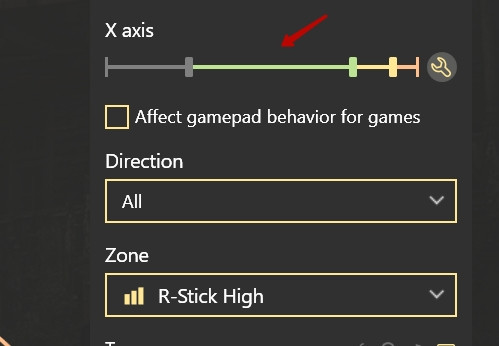

            Tried the workaround and for the most part it worked but when I flick the stick it wouldn't reactive gyro again. Gets kinda hectic during tense moments when I just want to flick the stick to turn quickly.
              Please try to make Low zone (green one bigger):

                Tried this but flicking and releasing the stick fast still results the same. Increasing the zone shape seems counter-intuitive for me since I want even the smallest movement on the stick to temporarily disable gyro.
                  It should work like that no matter how big the green zone is. When you increase a green zone like on my screenshot, you just make it bigger, so it will be active even if the stick is half-deflected. In order to make the smallest movement to emulate a command, you need to decrease the grey zone (deadzone).
