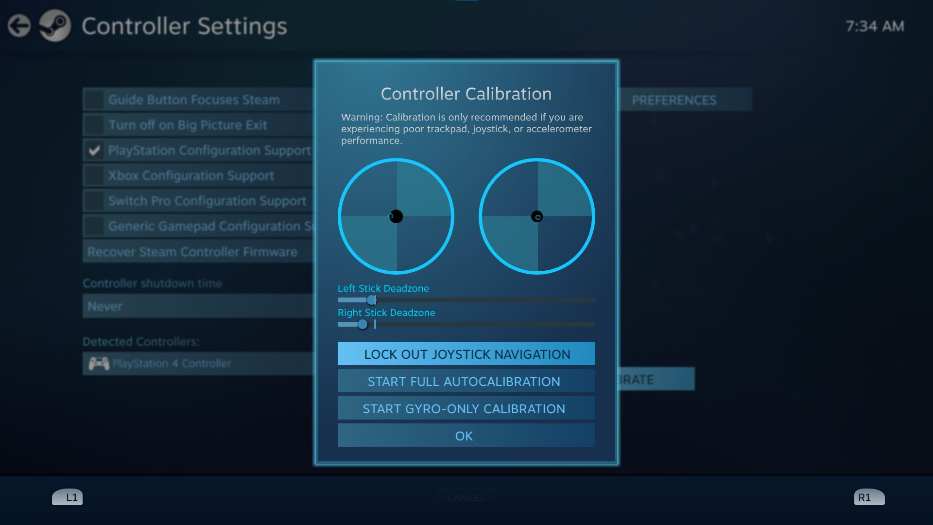

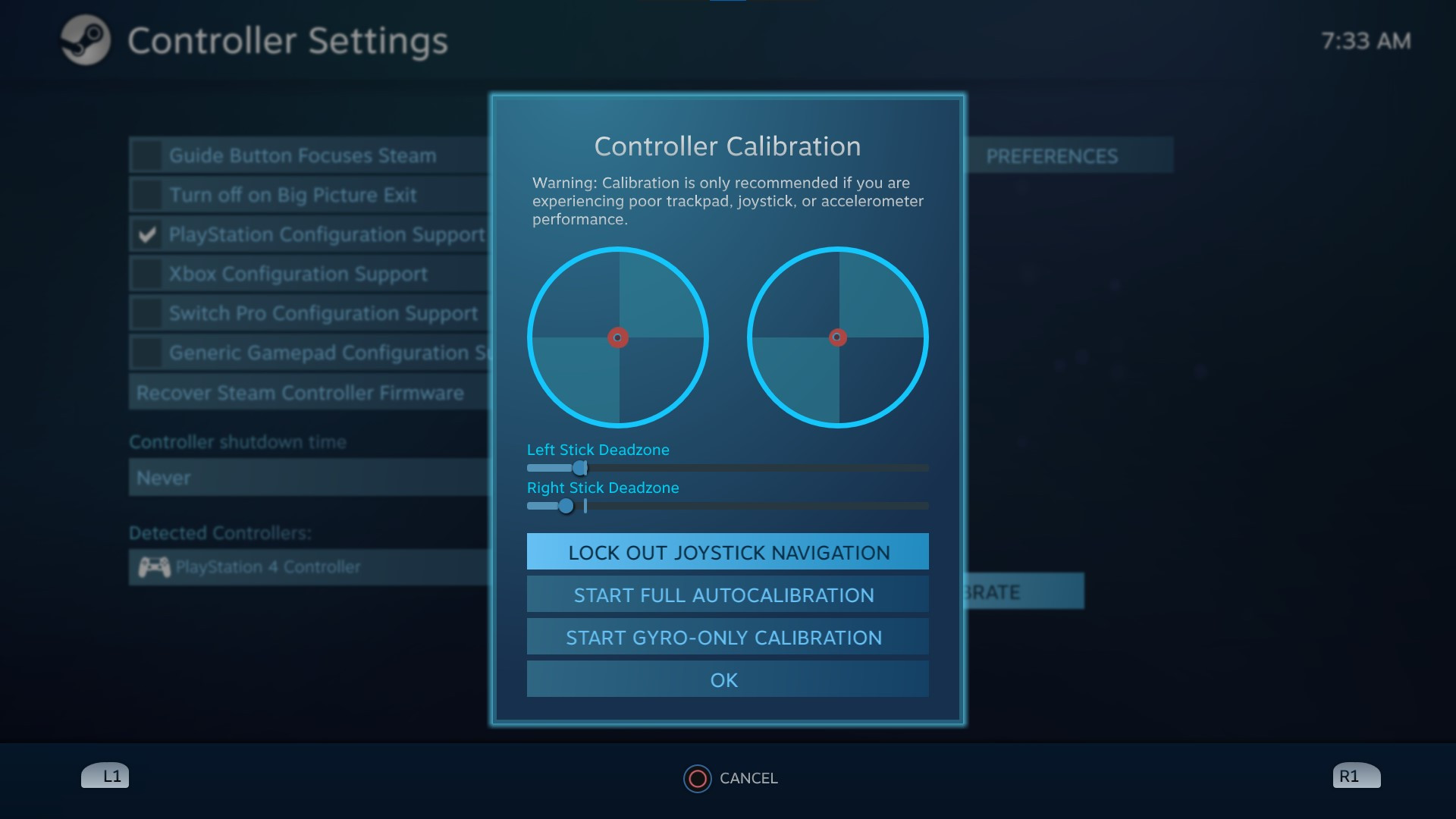

                Alright so thanks to the recent update for virtual DS4 with fully native gyro, I was able to use steam input's way for me to handle disabling gyro with the analog stick. However, I also encountered the same problems with it too where gyro wouldn't turn back on sometimes. My actual DS4 controller had no problem with it so I was wondering what might the problem is and I found out that it might be a bug with Rewasd. Steam has a calibration option for controllers and with it I can change the deadzones of the sticks and see a visual representation of it in use.
Name:	Deadzone Test 2.jpg
ID:	223322Click image for larger version
Name:	Deadzone Test 1.jpg
                As you can see in the first image, when the sticks are not touched at all the deadzone is colored black. But in the second image after moving/flicking the sticks, it shouldn't be colored red when it's inside the deadzone so I assume that it's still sending inputs even though I'm not touching the sticks. I thought it might be something wrong with my joycons but it wasn't the case since it also happened to my actual DS4 using Rewasd's Virtual DS4. Without using it there's no problem so it must be a bug or something with Rewasd at the moment. So with that in mind, the original solution of using toggle gyro with stick in Rewasd would've been flawless without this bug.

                    Changing the deadzone didn't fix it unfortunately. It still sending inputs like the images I sent.
