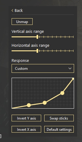

    Have you tried to create to create a curve that looks like this:
    Your stick should move only a little even when you push it to maximum.
    Also, I have one more question. How do you actually use the controller in emulator? Do you switch it to Xbox 360 or use keyboard mappings?

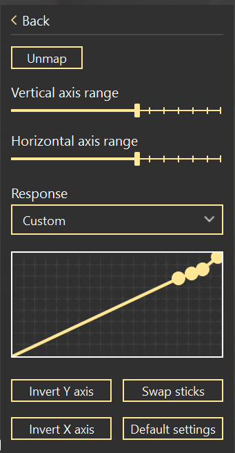

      I use the controller in the emulators just as 360 (or whatever the other generics name themselves)you settings actually made it worse ..but did help me in that I didn't know you could bring the last one all the way over and kill the top end.....ultimately I had to kill all deadzone cause this generic 360 controller apparently starts from zero right away, no deadzone cushioning so the settings I used are below...I can tiptoe in marios 64 using retroarch and mupen now.. before he would full run almost immediately

        Sorry I'm not sure if I understand you correctly.
        The settings you used before are almost similar for the default stick response curve. The one that allows you to get 32k output when you maximize the stick deflection.
        If you want to get a smaller output, you need to reduce "Y" value. Here is what I have done in my first post. With that curve, your stick output is much lower than it is. Isn't it the thing you wanted to achieve? How could this curve make everything worse?
          I don't know...default, it goes to full on run almost as soon as you move the stick, very lightly twitch it and he will walk but not tip toe... with your curve it is just full on run....with the one I made, he tip toes and walks before running... I am not sure how the curve sections work, but the middle 2 dots seem to make the most difference for where the top end kicks in... and the first one, the higher on the scale, the better the bottom end (tip toe, walk) response is

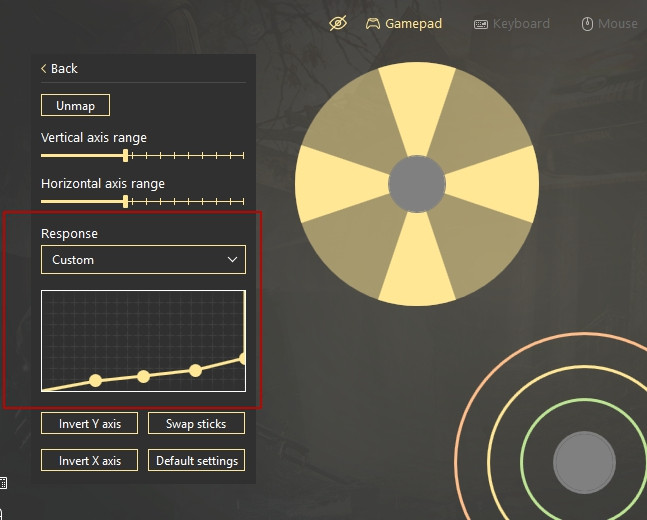

                    Well, you need to tune it more I think. This one may help:
                    Here, the character should move slower while the stick deflection is small and then run.
                    Could you please apply this one and try it in the game?

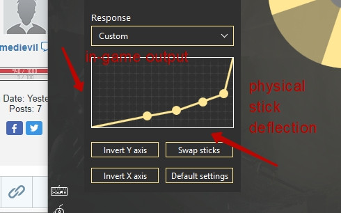

                          Unfortunately, without a controller I'm not sure if I can find the proper curve.
                          I will try to explain how it works, and will recommend you to try different options by yourself.
                          X axis shows the physical stick deflection. Y axis shows which output you get.
                          As you can see above, I have about 1/4 of output while I move stick from the deadzone to 1/2. Then, I get bigger output.
                            ok, so as you go across the bottom it is bigger stick movement from none to full??.. that helps a lot to know!!

                              Yes, you are correct. The bigger Y value is, the higher output you get. X stands for physical movement — from none to full.
