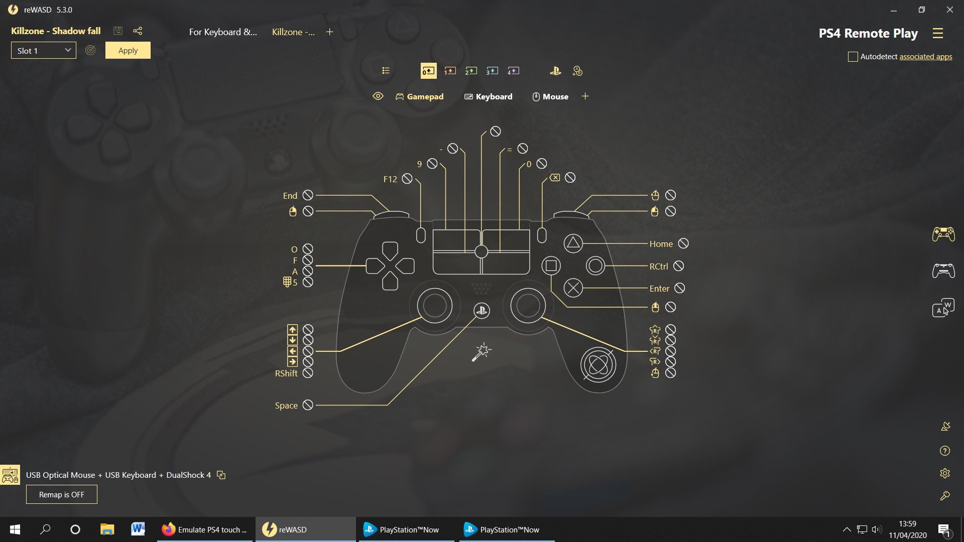

              I buied the program, I would like to set the last 4 buttons near backspace (8, 9, 0, ') for the Ds4 touchpad. I unmapped the 4 buttons but it doesn't work. What am I wrong? I send you screenshot of my REWASD settings.Click image for larger version

              • #22
                I am not sure if I get you correct.
                Are you using a physical DS4 controller? Do you want to tap a physical touchpad zone to get 8, 9, 0, '? Or do you want to press those Keyboard keys to emulate touchpad taps?
                • #23
                  Hi, this is my problem: I am playing Killzone Shadow Fall, and this game requires the touchpad to activate some features. I have a DS4 connected to my pc, and with your program I play with keyboard and mouse, cause I remapped all the other buttons of the DS4 in the buttons of KB&M. I play great with your program, because thanks to it I can play with KB&M, my preferred devices. I play very well, but when I try to remap the DS4 touchpad I can't. With REWASD I tried to set 4 buttons, each one for the 4 different zones of the touchpad, but I doesn't work. I tried all the options, and no one works. I need to remap the 4 different zones of the touchpad in 4 buttons of my KB. If this is not possible (but by reading your previous posts it seems possible) at least I would keep on the original touchpad of DS4: it means that when I have to use the touchpad in the game I take immediatly the DS4 for few seconds, and after that I used the touchpad I return to play with KB&M.
                  Am I clear?
                  Thank you!
                  • #24
                    Thank you for the details!
                    Unfortunately, at the moment, reWASD allows adding new actions to Touchpad zones, but it is the opposite to the thing you need
                    We are working on Swipes and Taps emulation, it will appear in the next version that is coming in the first half of May.
                    At the moment, I would suggest you to remove DS4 from the group and use it as a separate device. Then, you may be able to control the game with Keyboard and Mouse and use the physical device when it is needed. I'm not sure that the game will be switching between two devices flawlessly, but it may, so it is worth trying.

                    At the moment, you have unmapped your DS4 and so the game doesn't detect its input. You do not need to unmap or remap a physical DS4 in reWASD for your case.
