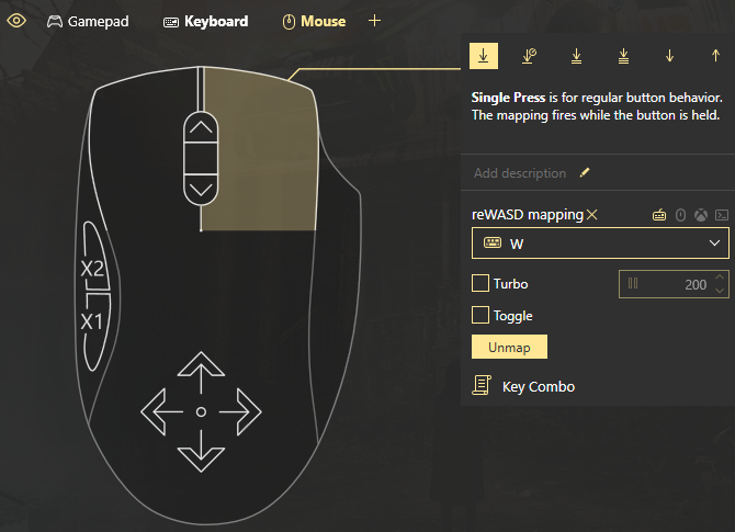

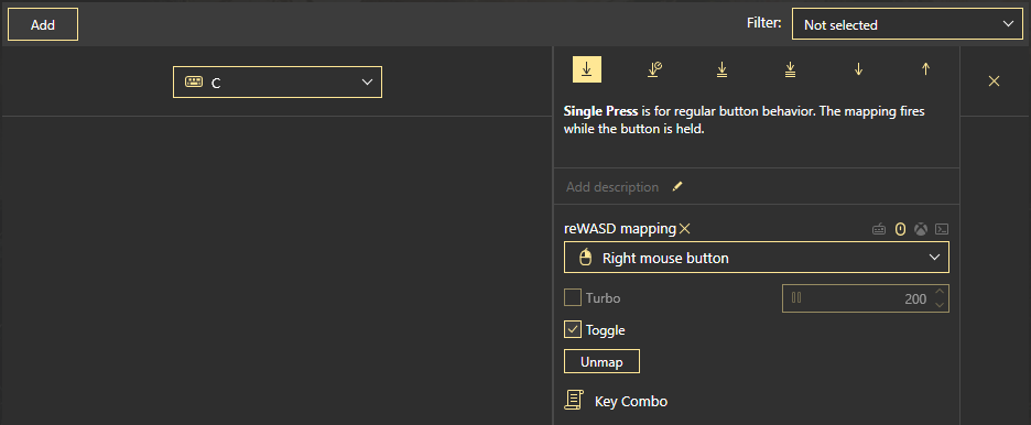

    With [Rapid fire] feature it is possible to toggle the mapped key/button between pressed/released state. So you can set, for example, a [C] key mapped to [RMB] in [Toggle] mode, while having [RMB] mapped to some other usefull key with [Unmap] flag enabled. [Unmap] is a part of [Advanced mapping] feature.
    Click image for larger version  Name:	image_2020-10-28_040342.png Views:	0 Size:	22.7 KB ID:	222125
    Click image for larger version  Name:	image_2020-10-28_040607.png Views:	0 Size:	175.7 KB ID:	222126

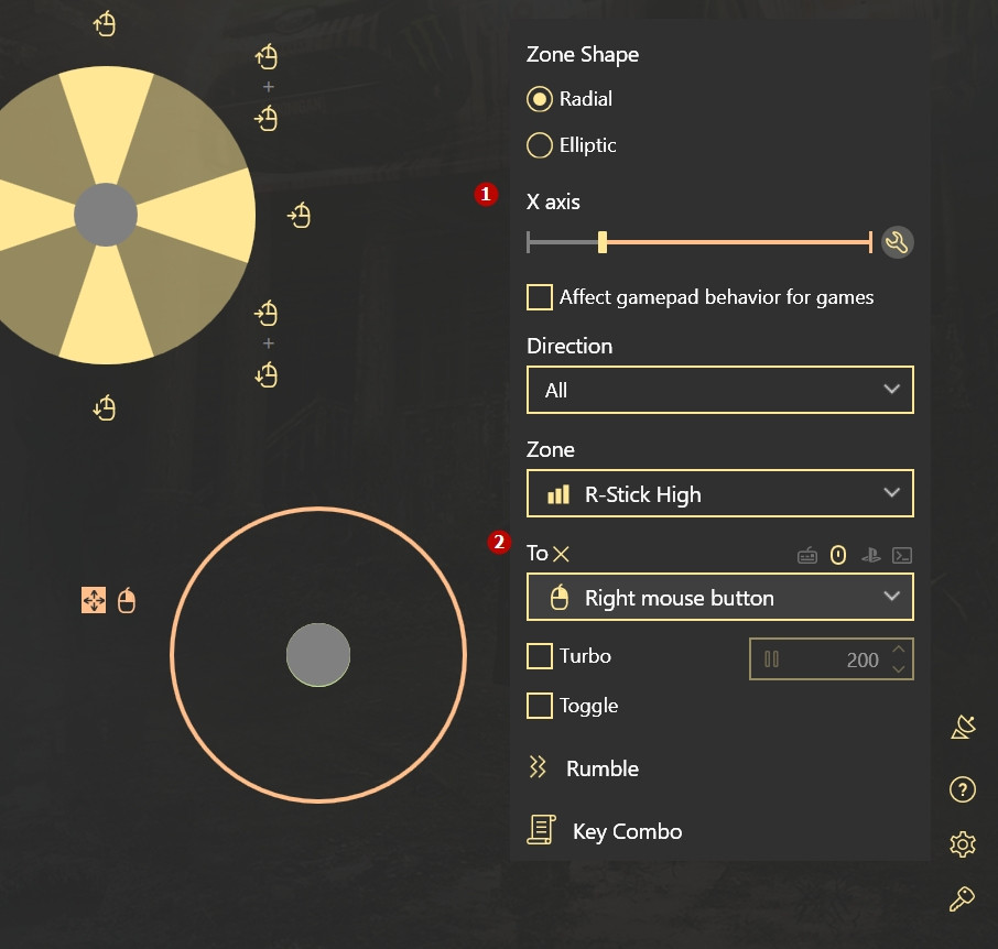

        So you're going to play with a controller mapped to mouse and keyboard? Like left stick to WASD, right — to mouse, and when you deflect the right stick — RMB should be held, right? If so, you will need to use stick zones.
        After you map Mouse to stick, go to its Advanced settings. Change Zone Shape so there is only one zone left (1) and map it to the Right mouse button (2):
        Click image for larger version  Name:	51fc8d94df.jpg Views:	0 Size:	98.6 KB ID:	222139
        If you want Mouselook Lock to work only when you're moving the character with a left stick - change and map the left stick zones instead of a right one.

                The screenshot provided makes it possible for the right mouse button to be clicked as soon as your stick reaches the high zone.
                You can try setting the same for the mid-zone, activation zones can be adjusted to your wishes.
                Try different settings, try different zones, probably some configuration will suit you better. Just, it requires some time and efforts and I am pretty sure you will nail it!

                  Ok. I finally got it to work. I had to move the little lines together to the left.

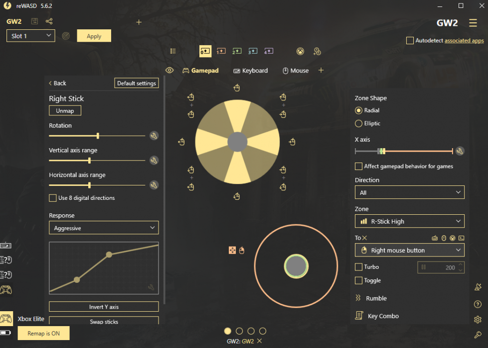

                          I have another issue with this configuration. When I'm moving the toon, the cursor sometimes moves to the extreme left of the screen making the camera rotate uncontrollably. Why is this? I've been changing the zone depth multiple times while chatting with you and nothing seems to work. I create the second layout with my original configuration to test this faster. The original configuration works just fine. With only one zone for the mouse, it makes the cursor go to the extreme left aggressively. I don't know what is causing this.

                            Please try changing the different response curves. This may happen because of the response curve being adjusted differently. This is all up to your settings and personal preferences.
