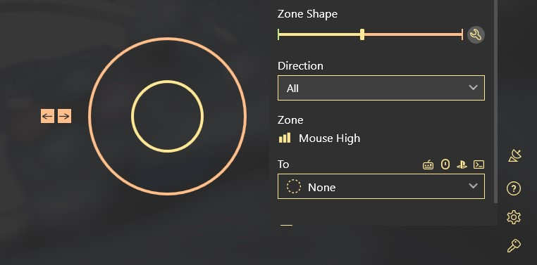

                  Config that you adjust in reWASD. Check the zone shape mapping and remove them if they are (screenshot). Check if the stick behavior has changed.
                  • #24
                    so this is what i have right now - what shall i changed it to?
                    i just tried changing the in game curve response to standard and the horizontal axis is still moving way more than how much i move it

                    • #25
                      Press "all" pop-down and check left and right directions, like that - http://recordit.co/6BeMSatkH7. Remove mappings. Apply config, check in the game.
                      Hope it will help.
                      • #26
                        perfect thank you so much - this has worked a treat - much appreciated - i will send the logs for the piranha shortly for you
