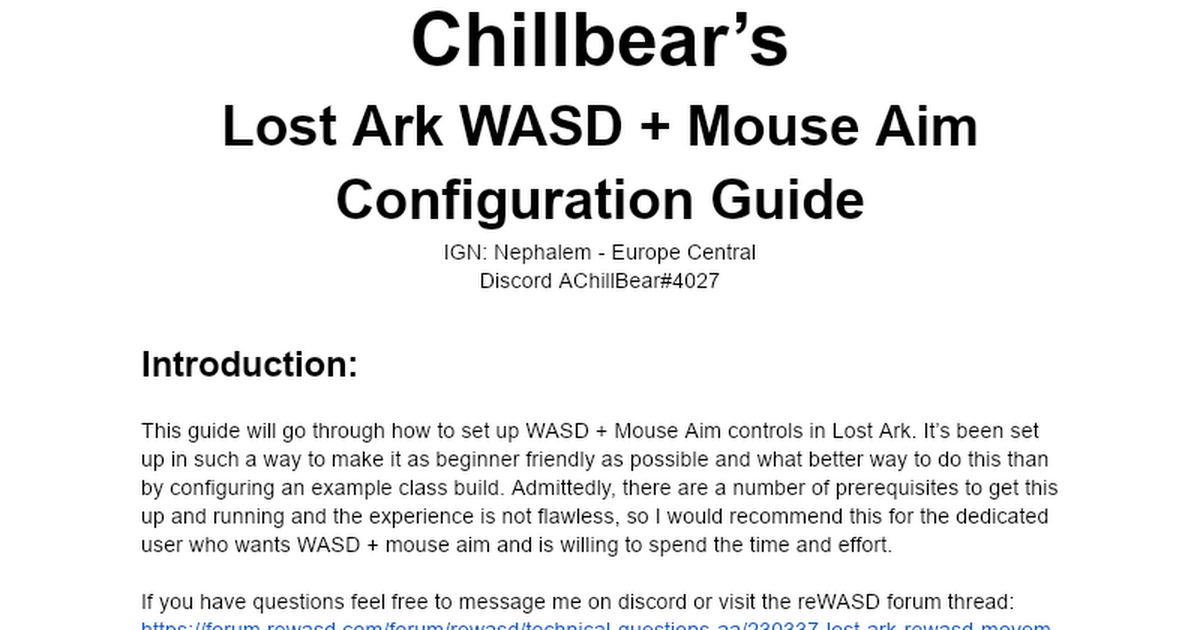

Hi guys! My guide is out on how to set up your own configuration in Lost Ark.
Hopefully this will get you going to set up WASD + Mouse Aim:

Hey tried you config on Sorc and its definitely in the right direction.Originally Posted by ChillBear View PostHi guys! My guide is out on how to set up your own configuration in Lost Ark.
https://docs.google.com/document/d/1...it?usp=sharing
