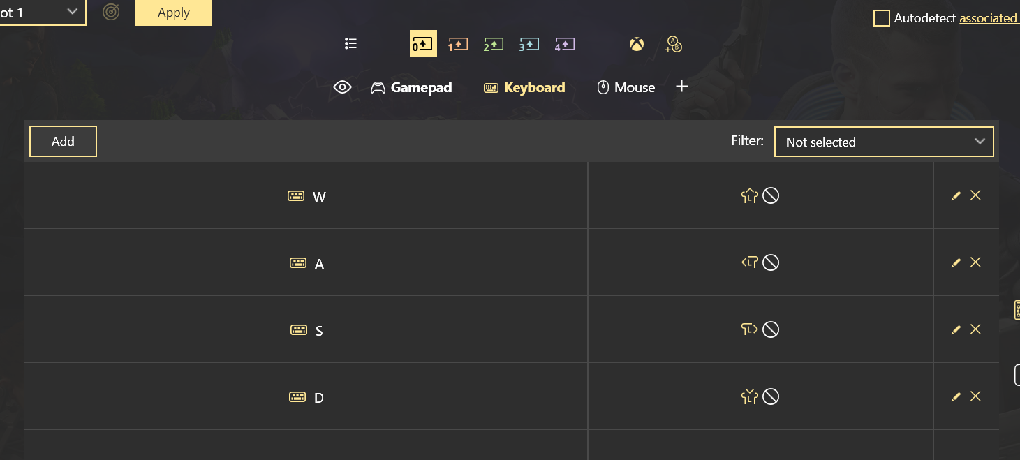

            In this case, please try to use stick movement for WASD, just like I have it here:
            You will need to apply this config for the Keyboard only (as it seems that Lost Ark is OK with using both KBM and controller together).
            Also, you need to ensure that controller's auto aim settings are on in the game itself — Skill Aim Assist, I assume.
            Please let me know how it goes — if it doesn't help, we will try to create a full config that switches your keyboard and mouse to the virtual controller.
