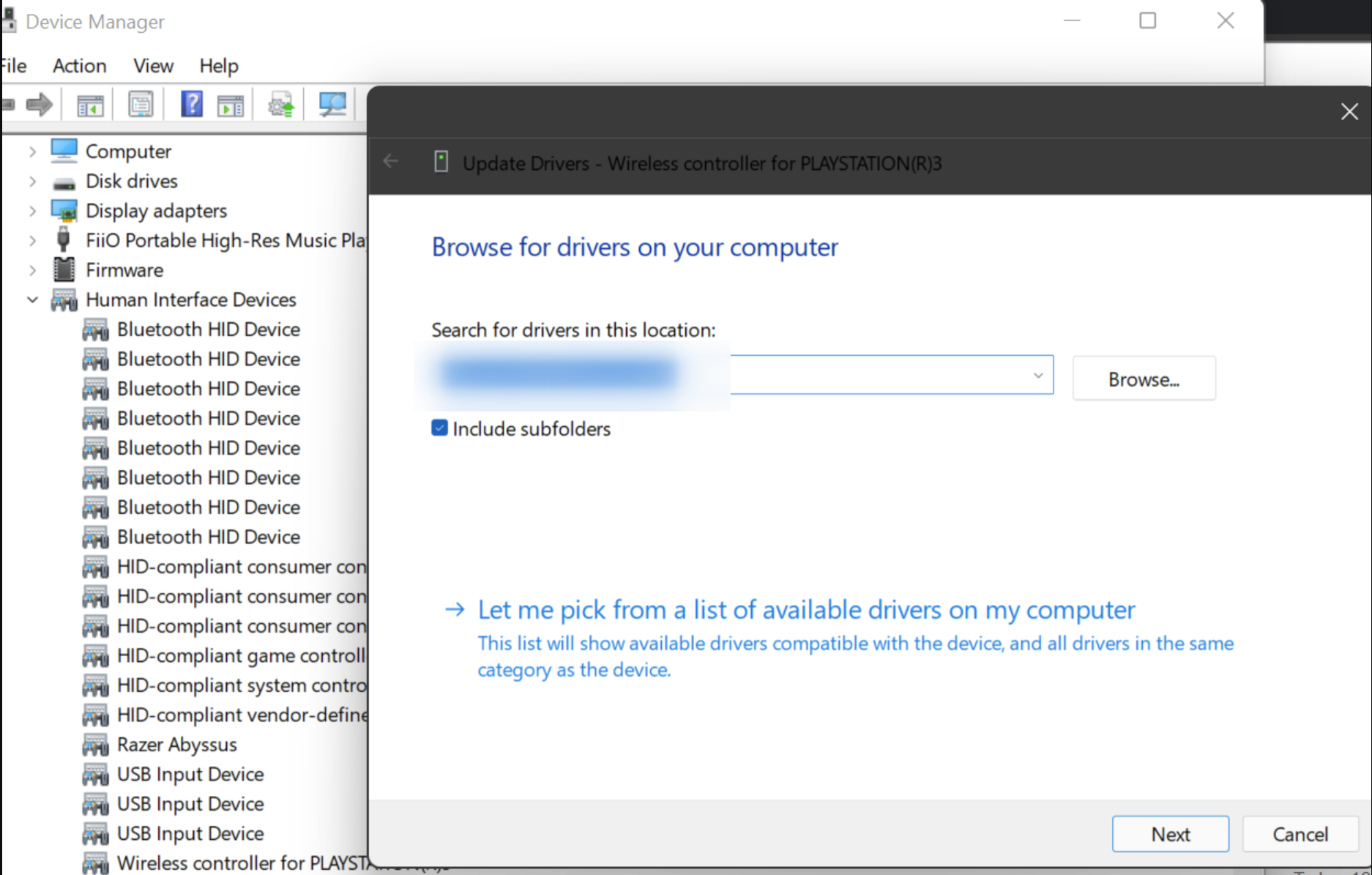

        Could you please also check which drivers are shown in Device Manager?
        Find your device in the list, click Update driver. Then, Browse for drivers on your computer -> Let me pick from a list...:

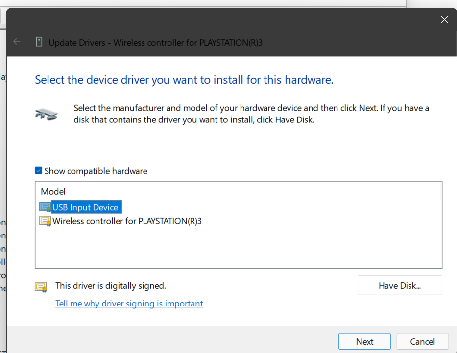

        Which things you see there? Please try different drivers if they are available:

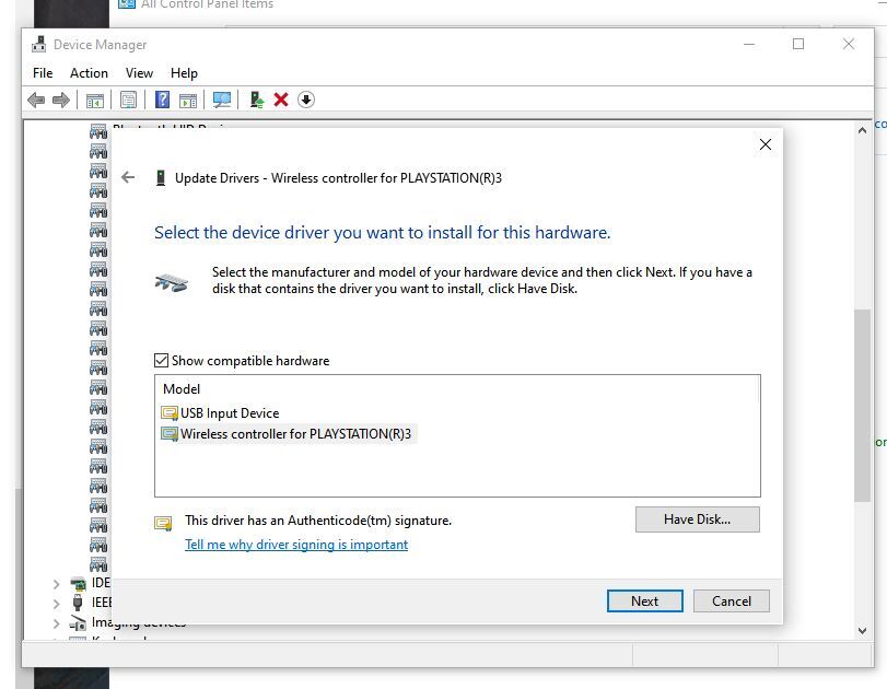

          My update drivers screen for the controller does show the same thing.

          It was listed in Device Manager as "Wireless controller for PLAYSTATION(R)3" already.
          I tried updating by clicking on "Wireless controller for PLAYSTATION(R)3" in the Driver update window, got a message saying the driver was updated, then tested for rumble and it didn't work.
          Then I tried updating with "USB Input Device" , got the same driver updated successfully message, and tested for rumble again. Didn't work that way either.
          So I switched it back to "Wireless controller for PLAYSTATION(R)3".
